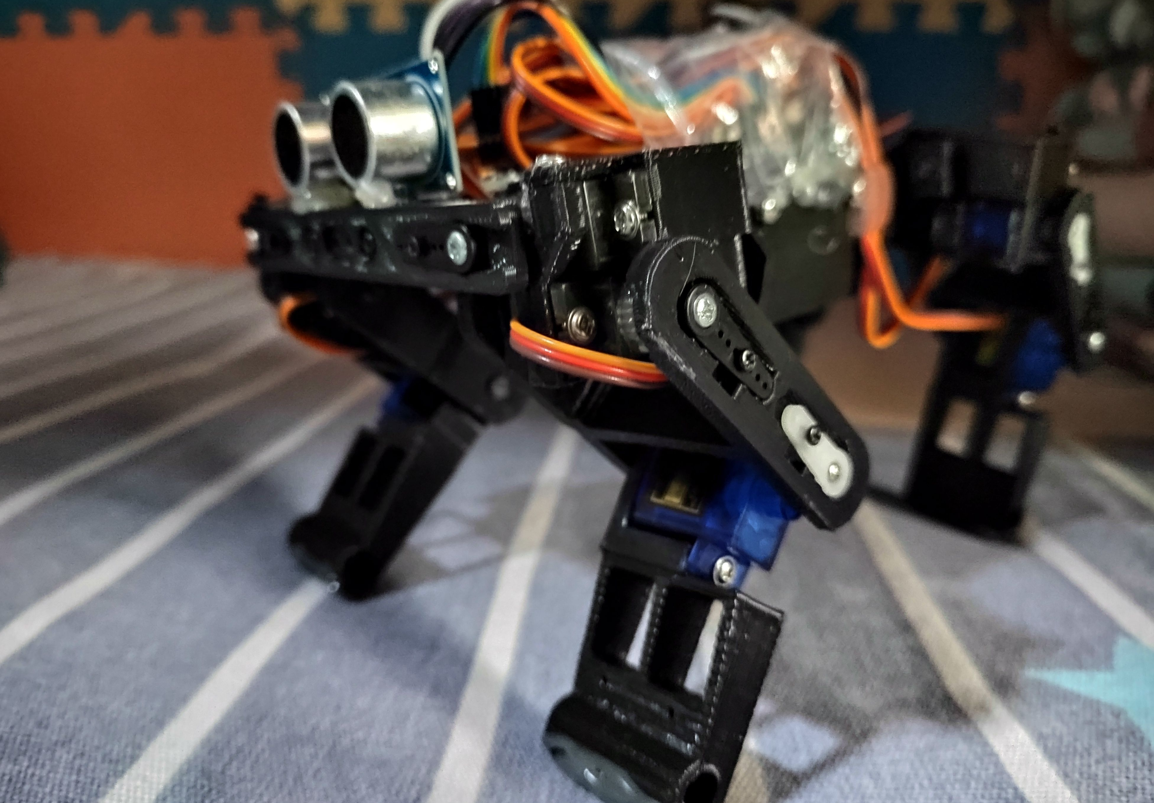

【Training Camp】Big Dog Licking Machine
The robot licking dog based on hi3861 has 12 degrees of freedom. The mechanical structure and gait algorithm refer to the design of Doraemon.IMG_20220722_145914.jpg
