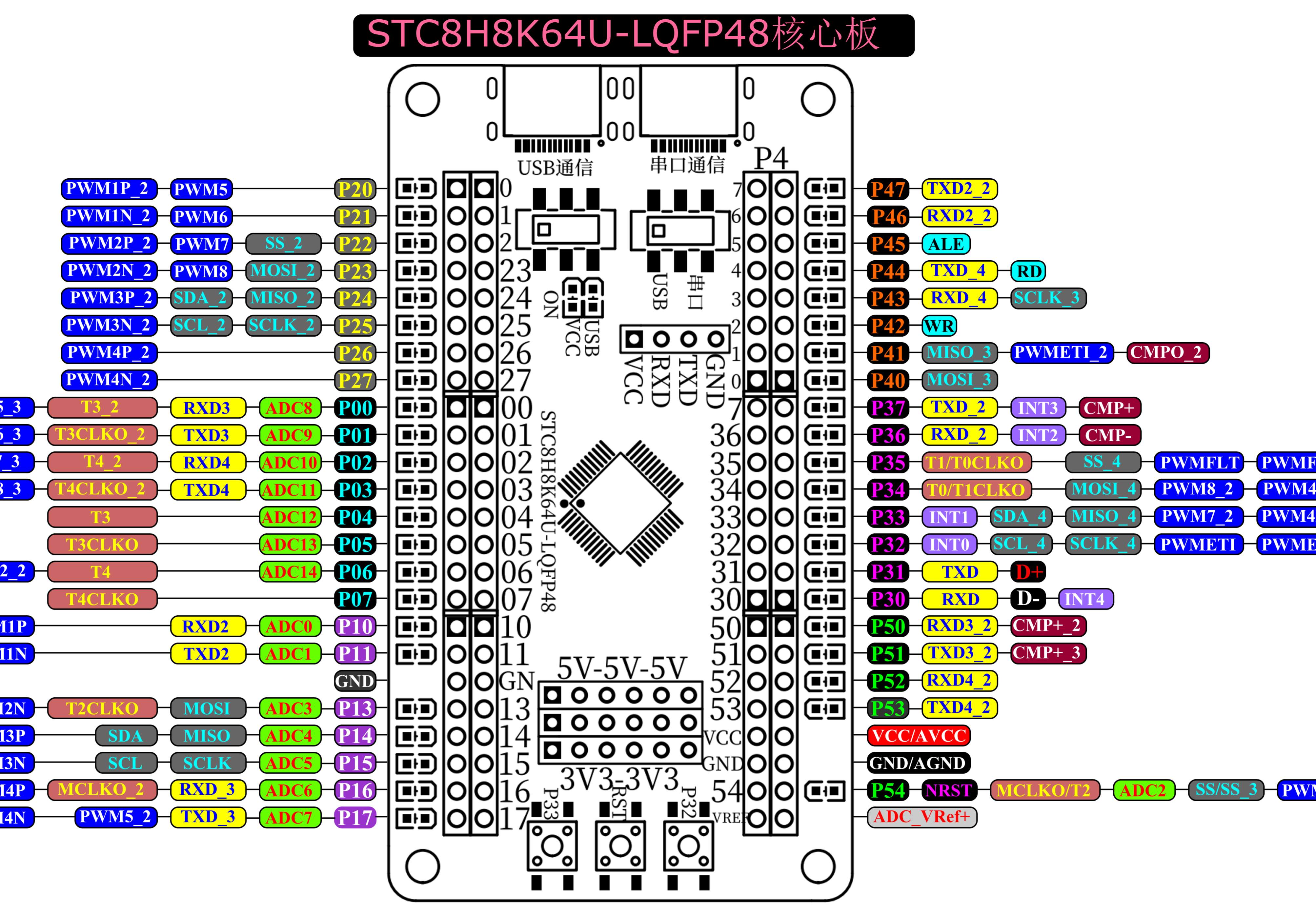

PCB level is just like that, mainly open source sharing the core board functional diagram drawn. Those who are interested can do their own research.
You can choose USB download or serial port download (CH340N) for the core board
. All the pins of the microcontroller have been lead out.
Each IO port is doubled for easy use, and each IO port is equipped with LED for indication.
TYPE-C is a 0.8mm countersunk plate. Please note that the 1.6mm countersunk plate cannot be welded.
I should test this core board later and make more videos.
A little trivia, compared to STC8H8K64U and TST8H8K64U, the current chip version is version B, which can be bought for 5 yuan and has DMA.
