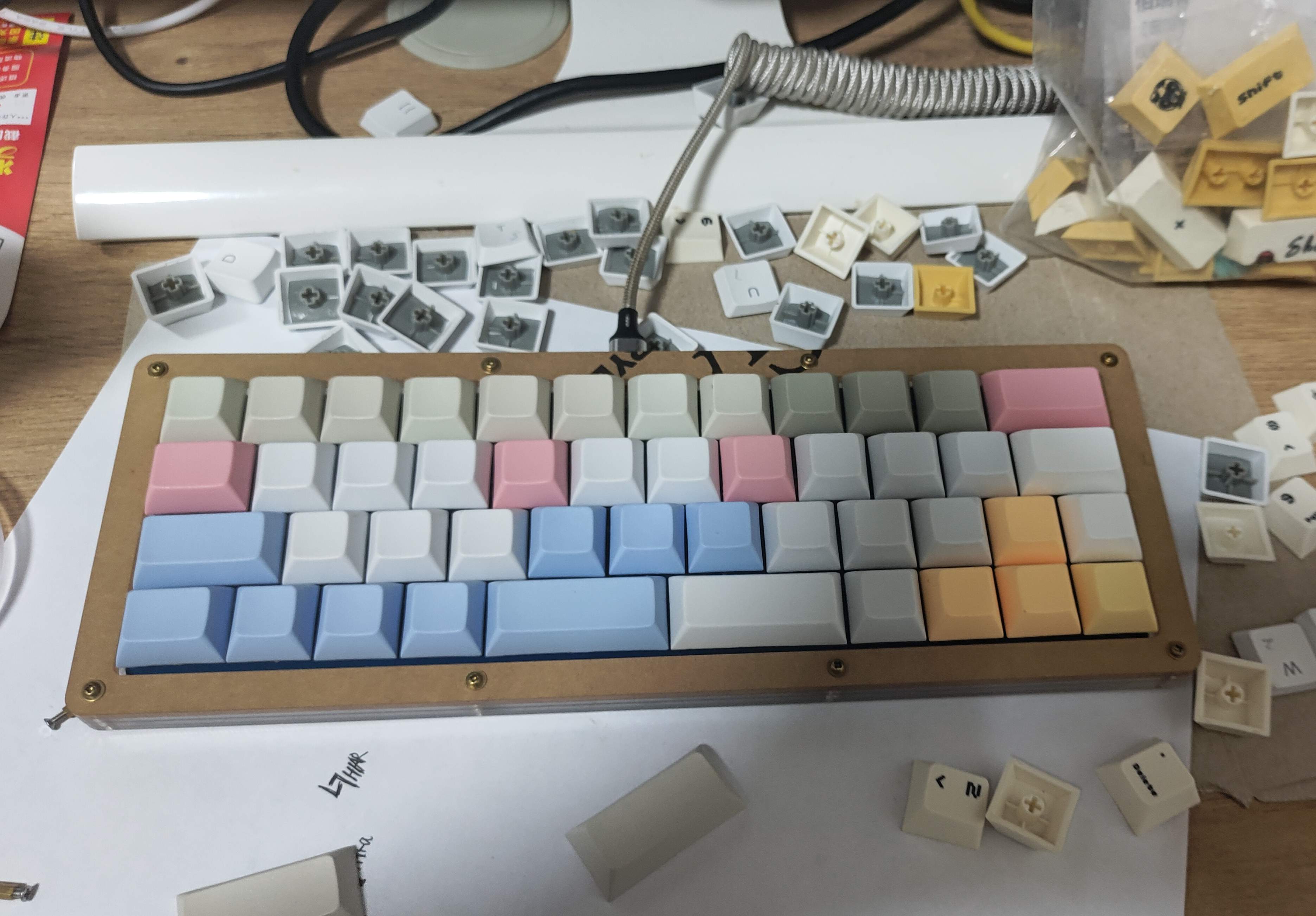

Imitation gasket structure 40% low axis mechanical keyboard
Original author->[https://oshwhub.com/lkaill/40low#P2](https://oshwhub.com/lkaill/40low#P2)
Only modified the pcb shape based on the original author's, and drew the acrylic stacked shell by myself , PCB and shell are extruded with pearl cotton. The screws are m2 type, and the shell drawings are open source and can be modified by yourself.
By the way, the source code light matrix and lighting effects have been modified to support via key changes.
