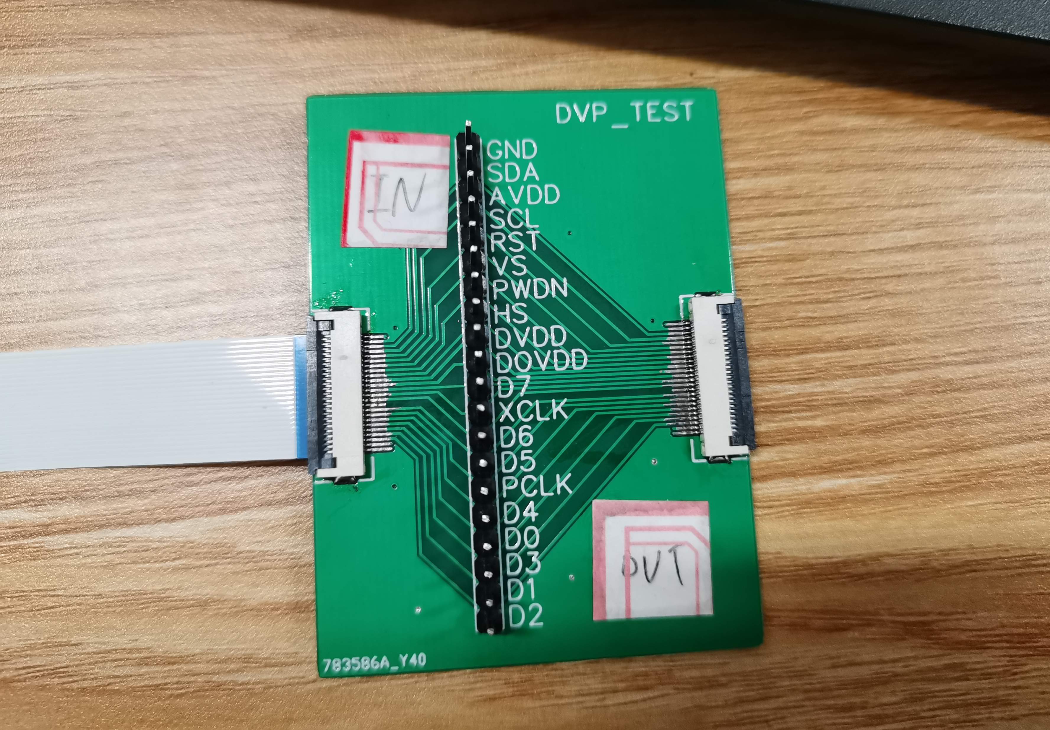

DVP test board
There are 0.5mm pitch 24P female sockets on both sides, which can be directly connected to the DVP camera, one in and one out.
Lead all the signal lines through the 2.54mm pin header, plug in the logic analyzer and you can see the waveform.
Each signal is labeled with a name.
There is no equal length, but if the frequency is not high, it will have little impact on the signal.
