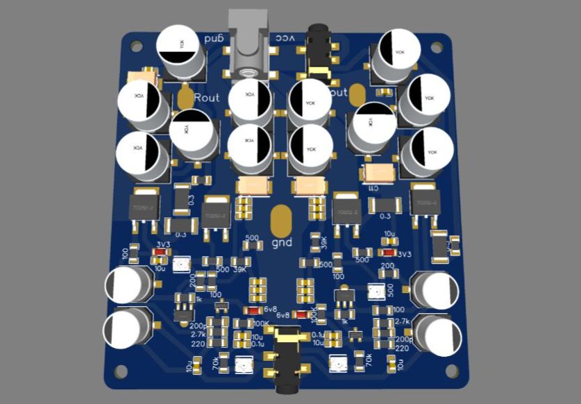

Discrete amplifier mos output version 1969
Printed shell, rca output
measured 24v power input, almost rail-to-rail output without distortion,
input 0dB standard level volume, no audible distortion,
the noise floor is very well controlled, even if you are close to the speaker, you can't hear it.
After attaching the board, first adjust the 20k Use the potentiometer to make the level at L12V/R12V equal to half of the input voltage, and then adjust the 500 ohm potentiometer so that the quiescent current is about 0.1-0.2a (multimeter milliohm range, measure the 0.3 ohm resistor of the output stage that is grounded voltage is enough), if the heat dissipation conditions are good, you can increase it appropriately.
