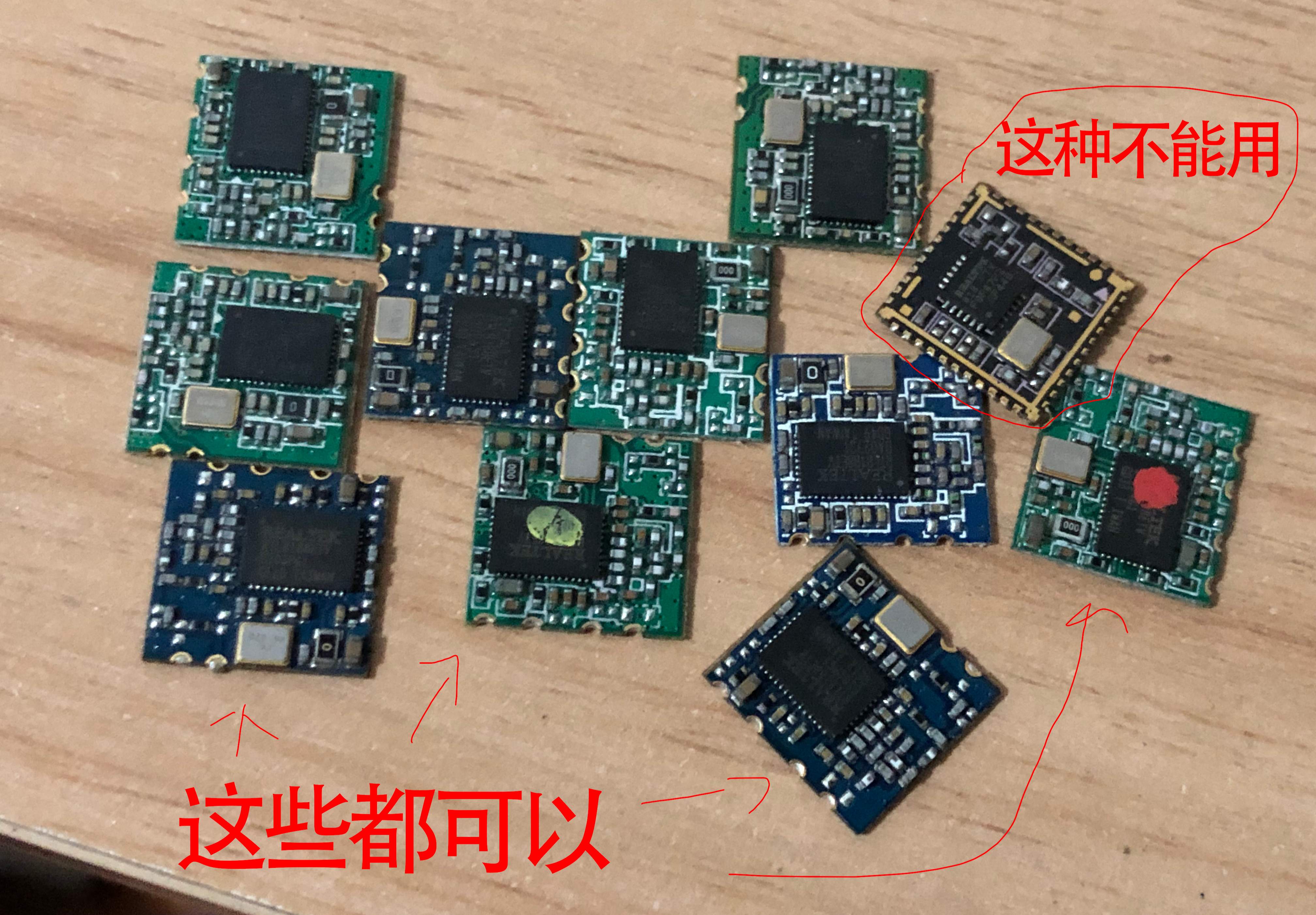

As the name suggests, this project is an adapter board that recycles idle RTL8188 modules. Although it is not fast, it is enough for emergency or non-pursuit purposes. Speed ​​of device usage.
Win10 driver-free plug and play! ! Win7 needs drivers! ! Drivers are provided for MacOS but have not been tested! !

----------I don't have this module, but I want to do this little thing. How do I get it? ----------
The wild RTL8188 wireless module can generally be found in TV set-top boxes, some cottage boards, copycat netbooks, surveillance cameras, low-end drones (toy-grade ones), and other equipment.
I personally don’t think it’s very cost-effective to buy a new tb to do this, but even if you buy a new one, the cost is still only more than ten yuan.
