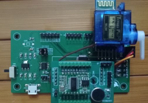

* 3. Physical picture
L0RcfkY35uMEsnAcqR8iPan02CL8vQGmno7wh8jp.pngVCKxCcuKInPsUO9mDrWEDFb21loB0sMvsiERf0Qf.png

Before this project, I had never soldered chips. I had only soldered switches, USB, and 0805 relatively simple components. The N32G430C8L7 chip used in this design is packaged as LQFP48. The IC pins are relatively dense. For me who have never soldered, it is a great challenge. During the soldering process, it is easy to cause the solder to stick together, and it is easy to solder the chip badly. After several solderings, I finally succeeded in soldering.
