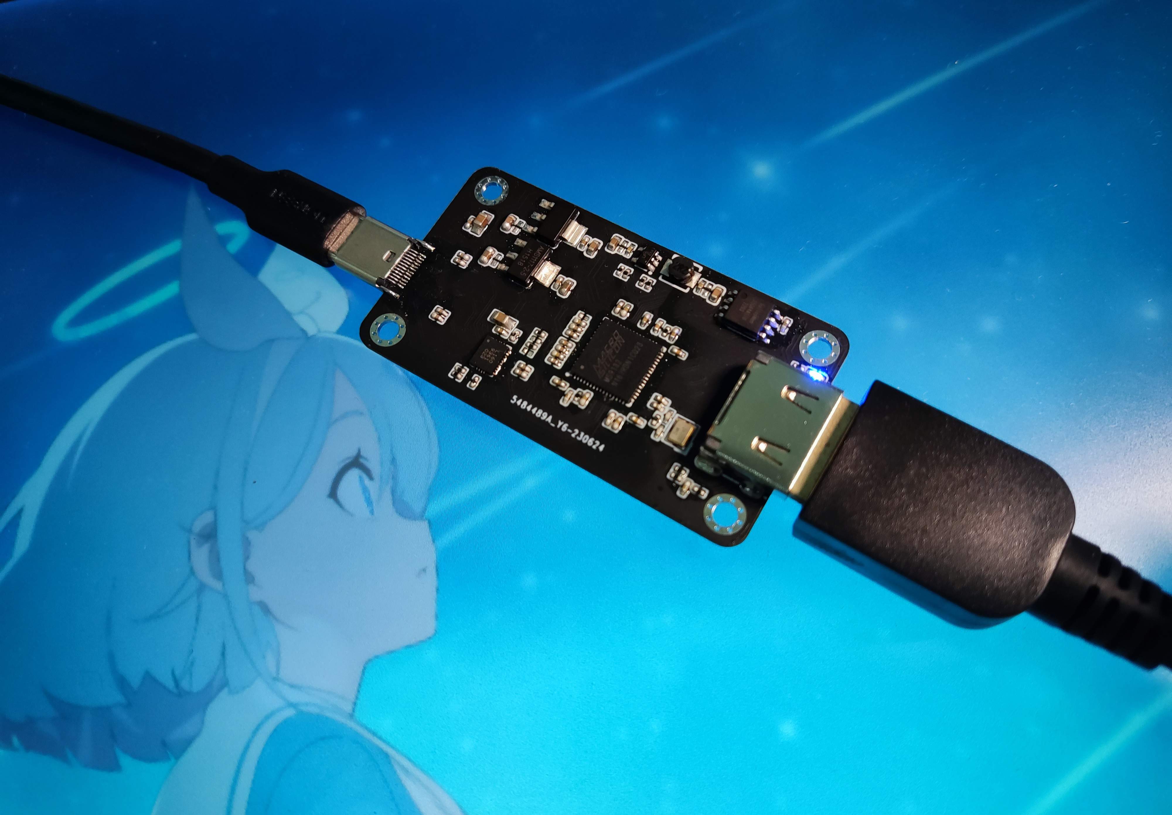

MS9132 is a USB 3.0 screen projection chip, which integrates USB 3.0 Device controller, data transceiver module, audio and video processing module. MS9132 can display or expand the information on PC, smart phone and tablet computer to a larger display device through USB 3.0 interface, and supports HDMI video interface output.
Background: 1. Mobile phone wireless screen projection has delay and poor picture quality, and more stable wired screen projection is needed.
2. The laptop has only one HDMI, which is inconvenient when two external screens are needed.
Function: Use the USB interface of Android, MAC or WINDOWS devices to project the screen through USB. The signal enters MS9132 and then transfers out the HDMI signal. Application: Mobile phone and computer screen projection, HDMI port expansion.
Main functions and features.

Impedance matching
HDMI needs to go through 100 ohm impedance matching
USB goes through 90 ohm impedance matching
Double-layer board, board thickness 1.0 If the driver is not installed

After insertion, the system will recognize it as MS USB Display.
The resolution can also be adjusted normally.
It is recommended to set it to 720P under USB2 and 1080P under USB3.
The effect is as follows: lower screen 4 is displayed externally via USB3.0.
The USB3 delay is about 100ms (mentioned below).

due to the USB instead of DP signal, delay is inevitable, and the delay is controlled within 100ms (USB3.0)
The delay of USB2 is visually estimated to be 200ms (see the video of Xiaomi tablet screen projection test).
However, since it is screen projection, although there is a delay, the sound and picture are still synchronized, and the sound follows the content of the projection rather than the local device (see the video of Xiaomi tablet screen projection test).
The sound and picture are separated using the function of MS9331 made before, and the sound in HDMI is decomposed.
In summary
, the MS9132 generates a lot of heat during use, but it is acceptable. You can add a heat sink depending on the situation.
Recommended level of project: hardware beginner~entry-level, pure hardware, the difficulty lies in the QFN chip welding
project cost: the main control chip will be more expensive, about 30, and the total cost below 35 is acceptable.
