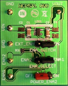

The demoboard supports the LDO regulator NCP571 with fix output voltage 0.8 V. An additional circuitry based on Single Input Buffer allows connect Enable signal with higher voltage than input voltage of LDO regulator up to 7 V. The ENABLE function allows turn the device to low consumption mode with quiescent current below 1 µA.Size: 38mm x 30mm x 18mm
Features and Applications
Input Voltage Range from 2.7 V to 12 V (Limited to 5.5 V in case the Single Output Buffer is powered too.)
Low Quiescent Current, Typical 2.7 µA
Output Current up to 150 mA
Precision 3% at Ta = 25°C
Internal Thermal Shutdown Protection
Current Limiting
NCV Prefix for Automotive and Other Applications Requiring Site and Control Changes
These are Pb-Free Devices
Hand-Held Instruments
Battery Powered Instruments
Camcorders and Cameras
