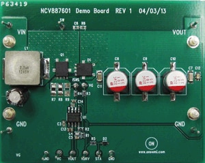

NCV887601BSTGEVB: Automotive High Frequency Boost Controller Evaluation Board
NCV887601BSTGEVB:  Automotive High-Frequency Boost Controller Evaluation Board
This NCV887601 evaluation board provides a convenient way to evaluate a high frequency boost controller designed to supply a minimum output voltage during Start-Stop vehicle battery voltage sags. The unit is in low Iq sleep-mode under normal battery operating condition and will wake-up when the monitored voltage drops below 7.3 V and begin regulating once 6.8 V is reached. Switching frequency is set to 440 kHz with a user selectable ROSC resistor. The evaluation board is rated 6.8 V / 3.6 A at a 2.6 V input voltage. Operation below 2.6 V is possible if output current is reduced.
Use the NCV8876 Evaluation Board SystemVision design and simulation environment to verify parametric and functional performance, and gain a better understanding of the features and behavior through live, virtual testing.
