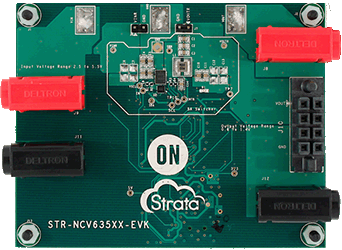

The STR-NCV6356-EVK provides an evaluation kit for the NCV6357 configurable 5.0 A adaptive on-time (AOT) step-down converter with an I2C programmable output voltage range of 0.6 V to 3.3 V in 12.5 mV steps. The NCV6357 also offers multiple operating modes: PFM for light loads, pseudo-PWM (PWM) for medium and high loads, and forced PPWM that can be set by the operator. The NCV6357 is suitable for automotive applications. This kit evaluation kit can be used with the Strata environment GUI to enable/disable the DC-DC converter, change operating modes, and monitor other telemetry data including interrupts, input/output voltages, power consumption, and temperature. For more details, visit the Strata web page at www.onsemi.com/strata! Click to Download Strata Features and Applications Features Vin range from 2.5 V to 5.5 V Maximum load is 5 A Programmable Vout from 0.6 V to 3.3 Vin 12.5 mV steps Adaptive on-time (AOT) operation with switching frequency up to 2.4 MHz Both PFM and PPWM operation with automatic transition 3.0 x 4.0 mm DFN-14 package Automotive and Industrial Applications DC-DC Power Supplies Automotive Instrumentation Instrumentation
The STR-NCV6356-EVK provides an evaluation kit for the NCV6357 configurable 5.0 A Adaptive-On-Time (AOT) step down converter a with I2C programmable output voltage from 0.6 V to 3.3 V in 12.5 mV steps. The NCV6357 also offers multiple operating modes: PFM for low load, Pseudo-PWM (PWM) for medium to high load, and forced PPWM which can be set by the operator. The NCV6357 is rated for automotive applications. This kit evaluation kit can be used in tandem with the Strata environment GUI to enable/disable the DC-DC converter, change the operating mode, and monitor other telemetry including interrupts, input/output voltage, power dissipated, and temperature. See the Strata webpage at www.onsemi.com/strata for more details! Click to Download Strata
