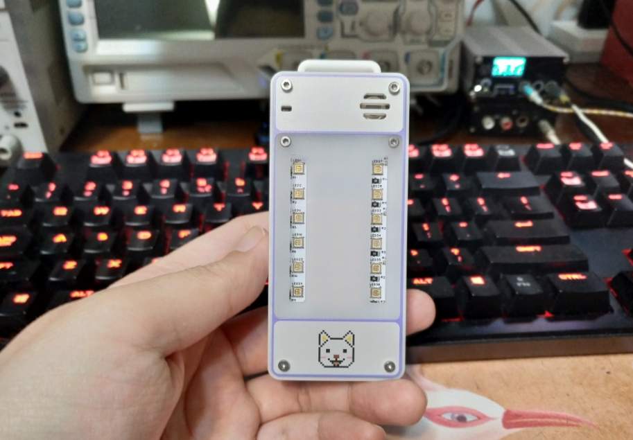

I haven't updated for a long time. Let's make a simple little thing.
The main control uses ESP8266 and the APP uses "Dian Deng Technology". It is a simple multifunctional IoT small production, designed for kitchens, corridors, etc.
1) Night light function, photoresistor (C125631) detects light. Use pyroelectric (digital pyroelectric sensor RDB226-S) or radar module (LD1020, TB purchase) to choose one of the two, choose the best.
It has been verified that the use of LD1020 radar module is better than pyroelectric, and the shell does not need to be opened. The price is also cheap (3.5 and free shipping).
LED uses 6 series and 3 parallels (4000K Ra95 high color rendering, C516132 is recommended), the color temperature is comfortable. Use constant current boost drive, maximum 5W.
2) Ultraviolet disinfection lamp, ultraviolet LED is much cheaper now, more than 2 yuan per piece. I used 12 275+395NM 3-5mW LEDs (C909692). Constant current boost drive.
This lamp is UVC UVA dual wavelength, here UVC UVA is connected in series, UVC VF 6.5V +UVC VF 3.2V=9.7V. So I use boost drive SGM3732 (C116578). The current is controlled at 40mA. 12, two in series and six in parallel. So the drive current is 19.4V 240mA.
3) Gas alarm, using MP-2 sensor. Detection alarm for smoke, methane, propane.
4) Thermometer, using 10K 3950K thermistor (C279936).

Shell part:
The shell finally arrived the day before the deadline and was installed. X resin, less than 10 yuan, good quality.
Heat the nut with a soldering iron and insert it into the hole. It is recommended to adjust the soldering iron tip to 250 degrees and use high-temperature tape to do it slowly (I was too anxious and overturned here and cracked a hole).
The front is printed on the (milky white frosted diffusion board finished acrylic 2.0) panel.
The transmittance of ultraviolet LED is low, so the acrylic is slotted.
The two magnets of 4*12*2 on the back are glued to the slot with a little red glue. It can be sucked on the refrigerator or something.

Night light, when the light is dark, it senses the human body, lights up, delays 30S and turns off, and continues to delay +30S when sensing the human body. It can also be turned on remotely by mobile phone (brightness is adjustable).
Direct ultraviolet radiation is harmful to the human body, and it needs to be turned on remotely by mobile phone (ultraviolet intensity is adjustable). After turning it on, the red light flashes to remind people to leave, and then it can be turned on again. If the human body is sensed during operation, the UV light will be turned off and the red light will flash until there is no human body sensing and it will continue to turn on.
Gas alarm, alarm above 500ppm, buzzer, red light flashing, remote mobile phone display. Manual
confirmation is required to turn off the alarm. Temperature alarm, alarm above 45 degrees, buzzer, red light flashing, remote mobile phone display. Manual confirmation is required to turn off the alarm.
