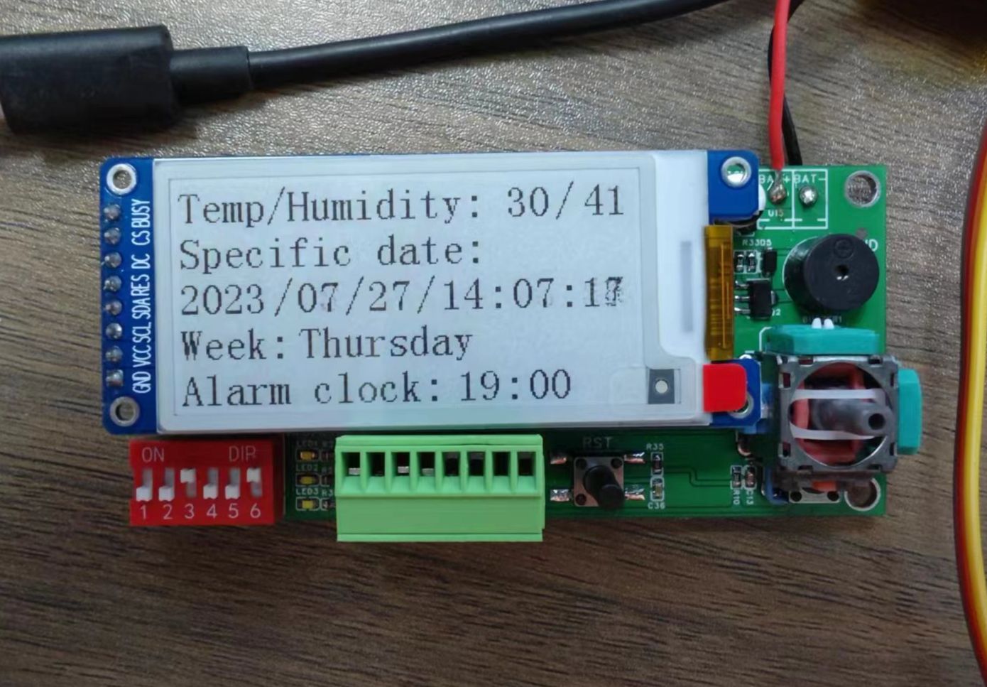

* 1. Introduction to project functions
1. 255*122 black and white ink screen clock
2. Lithium battery power supply, charging
3. USB to 485 (isolated)/232

*4. Hardware part
1. MCU uses R7FA2E1A72DFL
2. SPI 250*122 ink screen
3. USB to 485 (isolated)/232, using FT232RL, SP3232EEY, ADM3485, using BO5O5S to provide isolation for ADM3485, and using the dip switch to switch the mode. LED lights indicate the communication status
4. Joystick control
5. DTH11 temperature and humidity
6. Lithium battery power supply and charging, using LGS5500EP to manage the battery, and using HT7333 to reduce 5V to 3V. LED lights indicate the charging status

1. Keil project
2. The program attachment includes two versions
: no RTOS and freeRTOS 3. It includes two ways to drive the screen: hardware SPI and software SPI
4. ADC acquisition
Note: If your project involves software development, please upload the corresponding engineering source code in the attachment. Here you can explain in detail your software flow chart, functional module block diagram, explanation or popular science of related algorithms, source code structure, compilation environment construction and configuration, source code compilation method, program burning method, etc. It is recommended to introduce your ideas to others in the form of pictures and texts.
