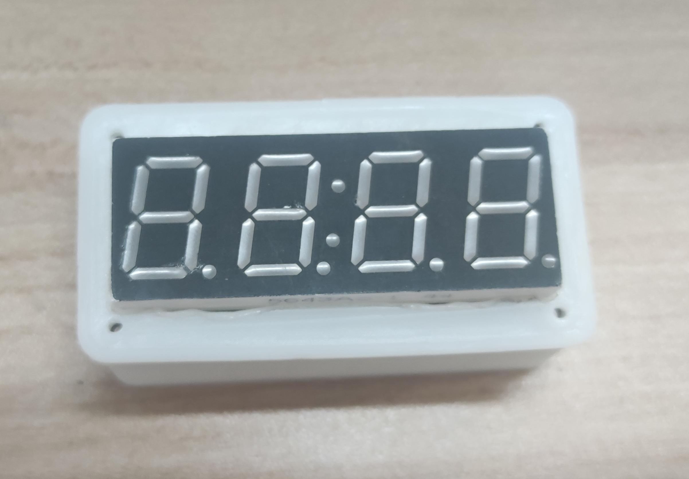

* 1. Project function introduction
Electronic clock based on R7FA2E1A72DFL, including automatic charging, RTC clock, display time and temperature and humidity, buzzer sound and other functions
### * 2. Project attributes
This project is for participating in the establishment The actual products of the 2023 summer training camp jointly branded by Chuang and Renesas.
The size and packaging have been optimized based on the original official case, and most plug-ins have been changed to SMD packaging to enhance the aesthetics. At the same time, there are more requirements for welding technology and equipment.
Considering that there is no Jlink on hand, instead of leading out the 4P* serial port and 2P*BOOT and 2P*NRST pads, you can use the 4P burning probe combined with tweezers to perform BOOT programming.
With the onboard CH340N, you only need to control reset and BOOT to achieve BOOT programming.
Problem:
* Since the digital tube was welded first during project development, AHT21 was not welded and will be added later.
* CH340N will be sent out inexplicably, which has not been resolved yet.

! [Contest LOG.jpg] ### * 8. Project photos
! [IMG_20230725_193334.jpg] ![IMG_20230725_185720.jpg] ![1690254348738.jpg] ![1690254348768.jpg] ! [ QQ screenshot 20230725121954.png] ![QQ screenshot 20230725121938.png]
