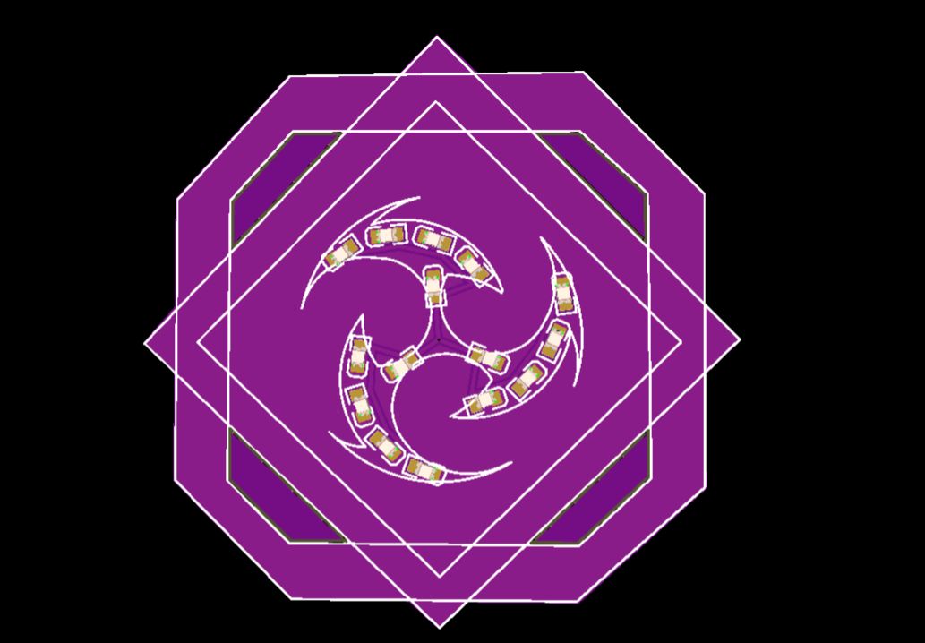

led purple lightning
A triangular wave signal generator is composed of LM358 and peripheral circuits; the triode forms a common collector circuit, which amplifies the triangular wave signal applied to the base, and because the voltage of the base is a triangular wave sandwiched on the DC signal, causing the emitter to The output voltage is an upward-moving triangle wave signal, which can control the brightness of the LED light to create a breathing effect.
