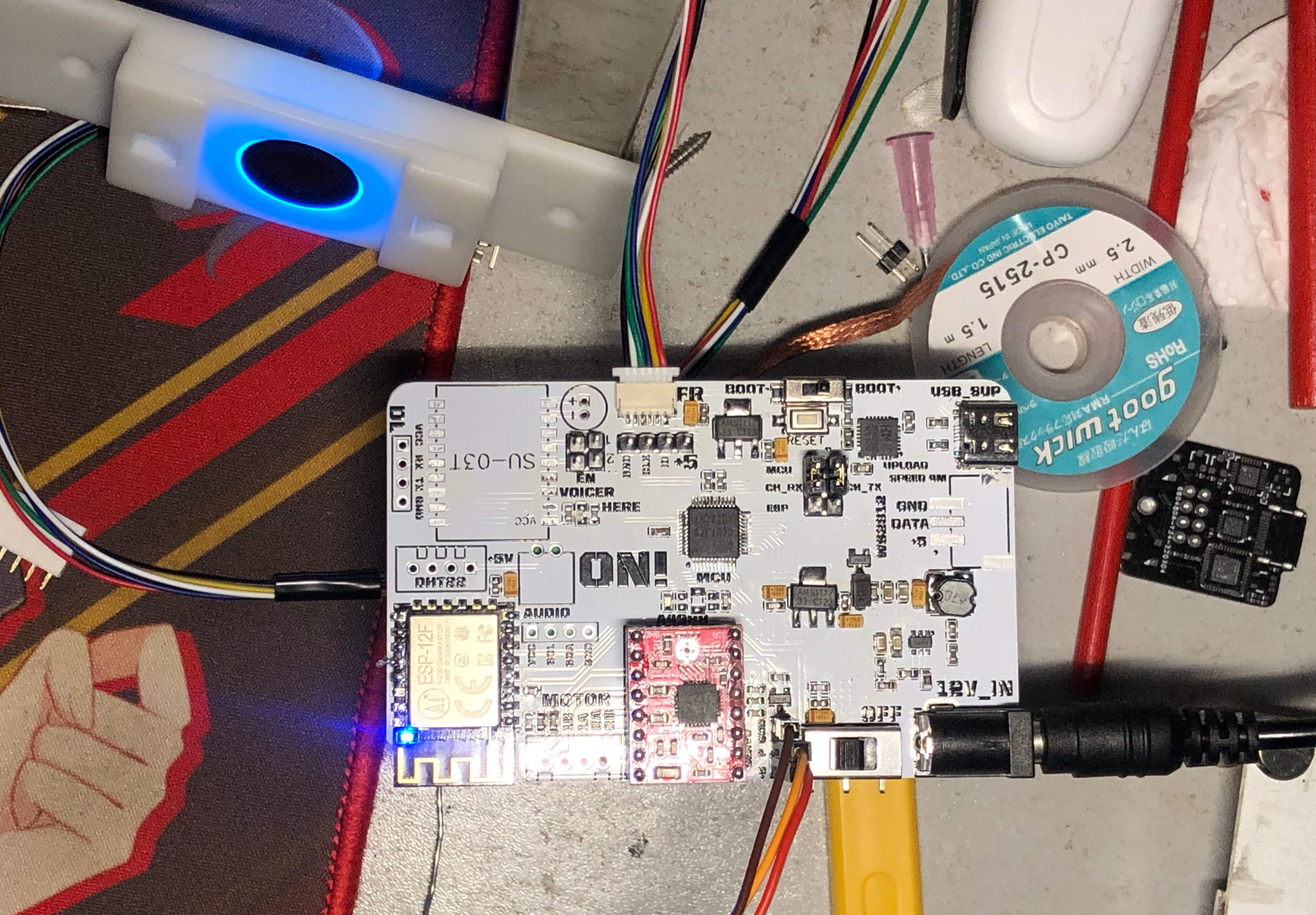

ON is a network lock. ON usually means switch, which includes the excitement and excitement when using a fingerprint to open the door. It is also the key to open my hardware open source life. In the past, fingerprint locks were registered and deleted by entering a password by pressing a button. , but ON is different. It communicates with ESP8266 through HTTP through the Blinker application on the mobile phone (that is, no matter where you are, as long as ESP8266 has a network, you can operate it, which is very convenient!), and then ESP8266 communicates with RA2E1 Perform serial communication to send commands! Then RA2E1 performs different functions through the obtained instructions!

ESP-12F (ie ESP8266) is a commonly used WIFI communication module. BLINKER communicates with MCU through HTTP protocol. BLINKER is the firmware module of ESP8266. It is simple and convenient to operate and supports various voice assistants on mobile phones! I am also new to BLINKER and it took me less than an hour to get started! The overall process is to declare a function, set the function callback, and initialize the function . I have set the following buttons by default. The functions include registering fingerprints and opening the door (because sometimes dirty hands may not be recognized), 12 types (plus 3 button states in total) 12 types) Lighting special effects (customizable), and who opened the door (subject to update) Since ESP8266 has so many functions, why not use it alone? This is what happened, even I was shocked when I said it!IMG_0655.PNG

A commonly used stepper motor drive module, why should we add a stepper motor module? Because the ordinary servo module cannot support large torque, a stepper motor must be added to support unlocking places that require large torque. I don't often use motors, so there may be errors in the circuit design . RST and SLP are connected to make the motor in normal working mode (RST is pulled up by default, SLP is activated by connecting to high level, shorting these two pins will be in normal working state), DIR controls the direction, and STEP input pulse can be stepped , I added pull-down resistors to the subdivision pins, and connected the MS to the MCU. In other words, I can control the subdivision number without jumping the cap, which is very convenient!
CH9102X serial port download
CH9102X is a high-performance serial port chip from Qinheng, with a download speed of up to 4M! At the same time, it is a QFN-28 package, smaller in size! There is an external 2X3 pin header. You can use the pin header to choose to download to ESP8266 or download to RA2E1. At the same time, you can also communicate with the MCU through the serial port for debugging. This pin header must be added, otherwise it will be directly connected to the ESP8266 and If it is RA2E1, the download to RA2E1 will fail!

DCDC step-down is used to power the MCU , WS2812B and servo . The actual power supply is normal at full brightness (the ripple is not measured because the oscilloscope can’t queue it up for me)! **But it is still recommended that the maximum brightness of WS2812 is around 128! **Two LDOs are used, one LDO supplies power to the fingerprint module (as for why it needs to be independent, it is written in the manual), and the other supplies power to the ESP8266 and voice assistant. It can be said that the power supply is very sufficient and comes with USB protection. The circuit supports USB and 12V power supply at the same time, so I no longer have to worry about burning my computer!
Fingerprint module
What I use is the Hailingke FPM383C fingerprint module ( actually other fingerprint modules also support other modules, which may not have enough performance and may not respond quickly, so an error message will be sent (5.3 update)). It costs 28 yuan each, very cheap, and has a good pass rate. It is still very high. It adopts the automatic verification fingerprint mode, that is, sending a series of instructions EF 01 FF FF FF FF 01 00 08 32 01 FF FF 00 04 02 3E will automatically verify the induced fingerprint. The identification logic I adopted is to put my hand On top (high level) -> MCU sends instructions -> fingerprint module verification, sends a string of data -> MCU receives variable length data strstr and finds the desired string segment -> correct identification/error return
Download guide
I use JLINK-V9. I typed it myself and it cost 50 yuan, or I bought it on Taobao for 90 yuan each. In order to take care of students who don’t want to buy JLINK, I have brought my own (serial port) download module, which supports 921600 download baud. Because the download file is usually not large, the actual speed experience is similar to that of JLINKV9. You only need to connect the communication pin of CH to the MCU through the jumper cap, and first adjust the BOOT toggle switch to BOOT- (the arrangement at the boot You can use a toggle switch for the pins, any pin pitch is 2.54), then press the RESET button, and then use RA's serial port download tool to download! If it is JLINK V9, you can omit the above step and download it directly with JLINK-LITE.
