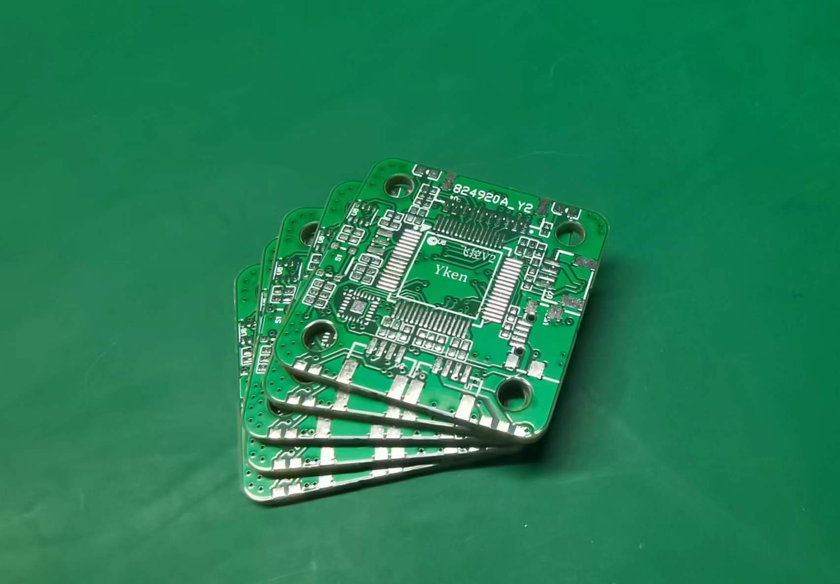

This work is a four-rotor flight controller, MCU: STM32F405RGT6, gyroscope: MPU6500, barometer: BMP280, OSD: AT7456E, black box: W25Q128JWSIQ, designed with ports for ELRS/SBUS receiver, image transmission, camera, and spare Two USART, one SPI, and one IIC interface.
After testing, this flight controller successfully communicated with the MPU6500, the BMP280, the AT7456E, and the black box. And the test flight was successful.
