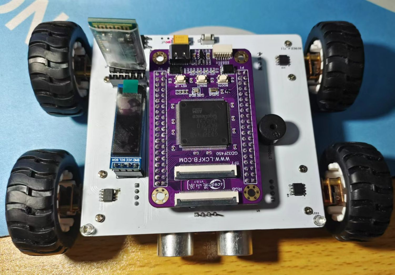

Bluetooth remote control car based on Liangshanpai development board
The smart car can use ultrasonic distance measurement and display information on the OLED screen. If the distance of the object in front is less than 10cm, the buzzer will sound an alarm. The Bluetooth module can be used to control the car to move forward, backward, rotate left, and rotate right. The LED light in front of the car will light up according to the direction of rotation. The car can also detect the battery adc voltage and display it on the screen. Bluetooth control is to download the HC Bluetooth Assistant from the official website of HC on the mobile phone and then use the custom button to send data to the HC_05 Bluetooth module. The serial port of the development board is used to receive the sent data and then make corresponding actions (currently only basic operations can be completed and the code will be improved later).
There are some errors in the first design. The errors have been modified now. The modifications are as follows: 1. The ground connection of the buzzer is wrong. After modification, the original board is processed with flying wires and it has been verified to be normal. 2. The original board used PA10 to control the motor chip. Because PA10 is a download pin, the motor will rotate as soon as it is powered on, and sometimes the program cannot be downloaded. Then change PA10 to PB6.
# 1. Project Introduction
Bluetooth Remote Control Car Based on Liangshan Development Board
# 2. Function Introduction
Function:
1. Use Bluetooth to control the car, using the hc_05 module, and download the official control software of hc on the mobile phone.
2. The OLED screen displays the distance of the object in front of the car, the forward speed gear, and the adc of the battery voltage.
3. Ultrasonic obstacle avoidance.
4. Buzzer alarm.
5. The lights show different states when turning left and right, and the LED on the development board will display the running lights according to the direction.
6. The button controls the gear when the car moves forward.

## 6. Car light display
circuit design
! [QQ screenshot 20221220112759.png] Code part

## 9. Driving circuit
The driving circuit uses the driving chip RZ7889 to drive
! [QQ screenshot 20221220150331.png] Chip description
! [QQ screenshot 20221220150525.png] Because the text is too long, it is not allowed, so the code is attached.
## 10. Development board Wiring
![QQ screenshot 20221220152011.png] ## 11. Bluetooth software page
![Screenshot_20221220_152622.jpg] Bluetooth setting software
![QQ screenshot 20221220152833.png] Connect the Bluetooth module to ch_340, TXD to RXD, RXD to TXD, then press and hold the button of the Bluetooth module and power it on, then you can use the software to set the Bluetooth module.
## Summary
Some errors were found during the verification of the car, which have been modified in the original schematic and successfully verified on the original car.
