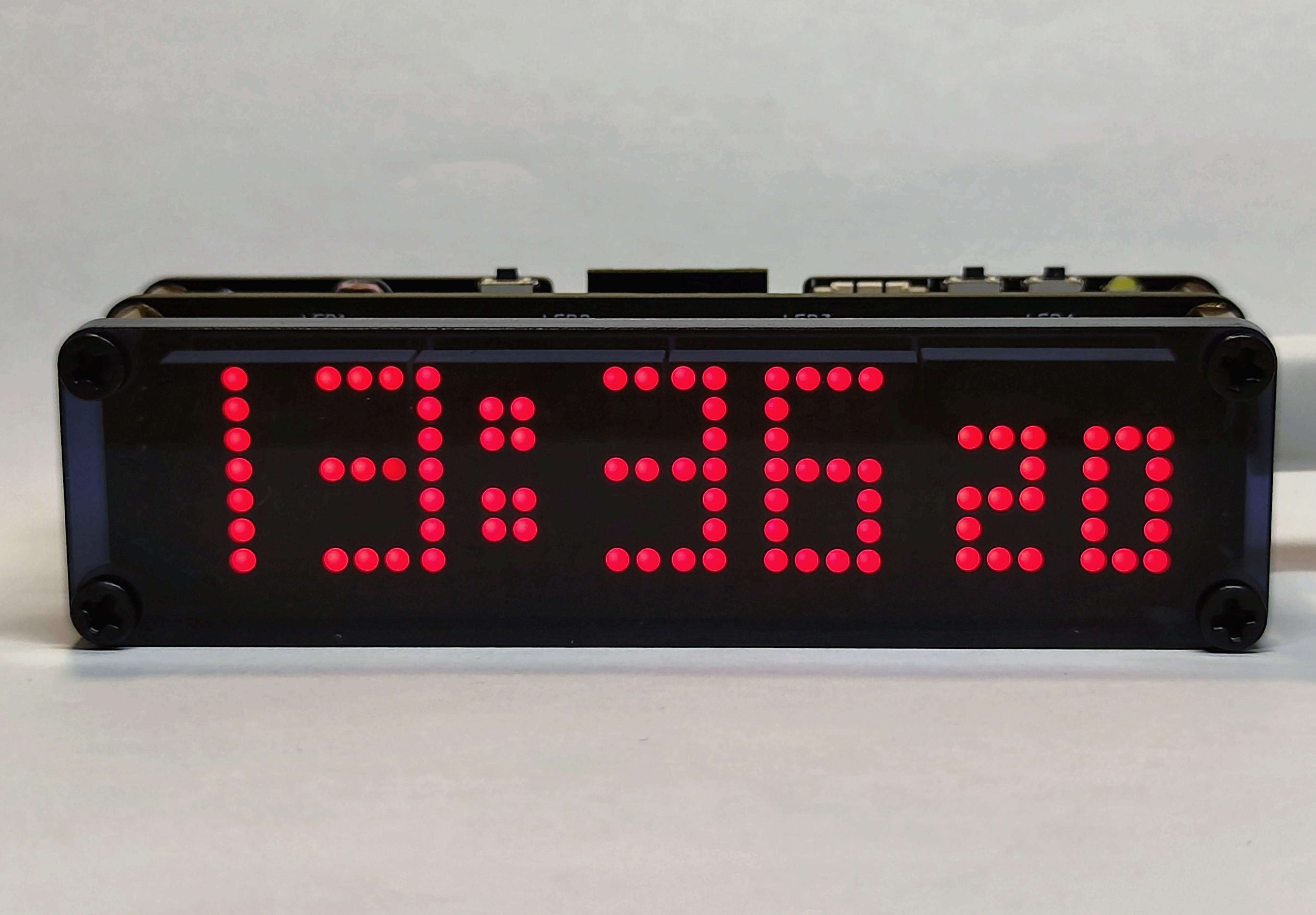

ESP32 C3 Matrix Clock
Written in front: The final version of the modified version,
which was modified from the original project ESP8266 matrix clock,
was completed as early as June 22. It also participated in the school competition and won the first place in the maker group (I even made a fool of myself one month before graduation). Award haha)
Main changes:
Hardware:
Use ESP32-C3-WROOM-02-N4 (4MB), which has more functions than ESP8266.
The clock chip is replaced with the common PCF8563, which is more affordable than the original DS3231MZ+, and there are many domestic alternative
power supplies. It becomes DC-DC. The LDO originally used generates a lot of heat and is not suitable for long-term operation.
Delete the serial port chip and directly use the built-in USB of ESP32-C3
to add a temperature and humidity sensor
and a screen power switch. Use IO control
to add a 1.25mm JST.
Software used for power supply :
driver, except for the screen driver, the rest are written in ESP-IDF
to connect to the Blinker platform.
Some notes:
power supply, you can use USB power supply or 1.25 JST
screen board, which is a bit different from the first version. Different, CLK and CS have swapped
the codes:
Contains Gitee warehouse and usage instructions:
An ESP-IDF version
Blinker version may be updated in the future. It has not been sorted and uploaded.
Demonstration video:
   It has not been completed.
