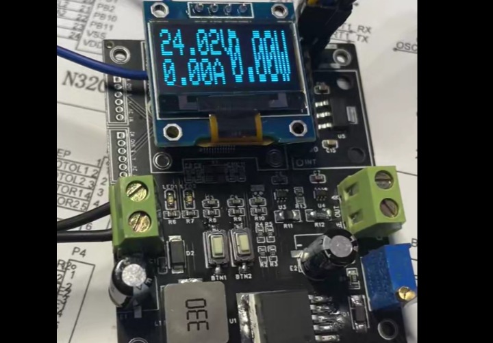

DC-DC boost
A simple desktop power supply, which boosts from a low voltage (such as 5V of a USB port) to 12V or 24V, etc. The output current can reach more than 2A.
Convenient for daily use. ;)
Current Sampling
The current sampling part is the INA199B1DCKR current sense amplifier, (also known as a current sensing amplifier) ​​which is commonly used in overcurrent protection, precision current measurement for system optimization, or closed-loop feedback circuits. This series of devices can sense the voltage drop across the shunt resistor at a common-mode voltage of –0.3V to 26V that is independent of the supply voltage. There are three fixed gains to choose from: 50V/V, 100V/V, and 200V/V. This series of devices uses a zero-drift architecture with low offset, so the maximum voltage drop across the shunt resistor can be kept to a minimum of 10mV full scale when performing current sensing. The parameters are as follows:
Common-mode range: –0.3V to 26V
Offset voltage: ±150μV (maximum)
Supports 10mV full-scale shunt voltage drop
Quiescent current: 100μA (maximum)
Sampling resistor selection
Inserting a low-resistance sense resistor in series in the current path will form a small voltage drop, which can be amplified and treated as a signal proportional to the current. However, depending on the specific application environment and the location of the detection resistor, this technology will pose different challenges to the detection amplifier. Generally, the resistance value of the sampling resistor is below 1 ohm, which is a milliohm-level non-inductive resistor. However, some resistors have sampling voltage and other requirements, so large resistance value resistors must be selected, but the resistance base is large and the error is large. In this case, it is necessary to select high-precision non-inductive resistors (which can reach 0.01% accuracy, that is, one ten-thousandth accuracy) to make the sampling data very reliable. Products such as ultra-low resistance resistors (0.0005 ohms, 2 milliohms, 3 milliohms, 10 milliohms, etc.), chip alloy resistors, high-power resistors (20W, 30W, 35W, 50W, 100W), etc. have a temperature coefficient of plus or minus 5PPM.
Sampling method
This sampling uses low-side sampling, that is, the sampling resistor is connected to the GND loop. This design can calculate the complete differential, follow, amplify, and output when the differential signal is sent to the op amp. If high-side sampling is used, that is, the sampling resistor is placed at a high position between the power supply and the load, although this placement not only eliminates the ground interference generated in the low-side detection scheme, but also detects the accidental short circuit from the battery to the system ground, but the high-side detection requires the detection amplifier to handle the common-mode voltage close to the power supply voltage. This common-mode voltage value range is very wide, ranging from the level required to monitor the processor core voltage (about 1V) to hundreds of volts commonly seen in industrial, automotive, and telecommunications applications. Application examples include the battery voltage of a typical laptop computer (17 to 20V), 12V, 24V, or 48V batteries in automotive applications, 48V telecommunications applications, high-voltage motor control applications, current detection for avalanche diodes and PIN diodes, and high-voltage LED backlights. Therefore, an important advantage of high-side current detection is that the detection amplifier has the ability to handle larger common-mode voltages. Therefore, the current sampling method of sampling resistor plus op amp is best performed at the low end. Although, low-end sampling will affect the ripple of the signal due to common ground interference. But compared with high-end, the solution is simple, easy to implement, low cost and high reliability.
The sampling resistors R11 and R12 in this case (see DC-DC boost diagram) are used to test the input current Iin and output current Iout
voltage sampling respectively.
The voltage sampling part consists of a voltage divider circuit composed of two resistors (two groups), and its principle is the knowledge of resistor series voltage division. It
is used to test the input voltage Uin and output voltage Uout respectively.

OLED screen display
4-pin OLED display, resolution 128*64.
UI display, human-computer interaction.
Communication method: IIC.

physical demonstration: voltage, current, power meter
