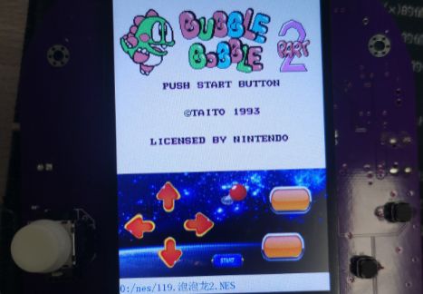

1. Project Introduction
  Based on the Lichuang Liangshanpai GD32F4 high-performance development board, make your own game console. This game console has transplanted NES emulator. Currently, general NES games can be played. There are hundreds of games available for download. In this project, we can learn the transplantation of LCD screen, the use of SD card file system, the production of simple UI interface, the function of music output, etc. In this project, we can recall our childhood.
2. Onboard functional resources
(Figure 1 PCB front)
(Figure 2 PCB back)
3. Key learning content:
1. File system, Fats read and write operation (SD card and Flash file system).
2. EXMC LCD driver (8080LCD interface)
3. Transplant NES display 240*240 to 480*480
4. LCD touch control and play games
5. DAC music output
6. Text library use
7. SDRAM memory management
8. Bmp picture file reading, storage and display

   After modifying the code, the program runs the game normally.

Secondly, the display driver of the game: the resolution of 240*240 is changed to 480*480, without increasing the video memory:
nes_ppu.c ----> void scanline_draw(int LineNo) function
extern uint8_t nes_xoff; //Display the offset in the x-axis direction (actual display width = 256-2*nes_xoff)
uint16 i;
uint16_t sx,ex;
do_scanline_and_draw(ppu->dummy_buffer);
  #if 0
  sx=nes_xoff+8;
  ex=256+8-nes_xoff;
  //printf("LineNo:%d sx:%d ex:%d
",LineNo,sx,ex) ;
  LCD_Address_Set(LineNo,sx,LineNo,ex);//Set the display range across the screen
  for(i=sx;i    //LCD_DrawPoint(LineNo,i,NES_Palette[ppu->dummy_buffer[i]] );
    //printf("i:%d color:%d
",i,NES_Palette[ppu->dummy_buffer[i]]);
    LCD_WR_DATA(NES_Palette[ppu->dummy_buffer[i]]);
  #else
  sx = 17;
  ex = 240+17;
    LCD_Address_Set(0,(LineNo*2)+40,480,(LineNo*2)+40);//Set the display range to display horizontally
for(i=sx;i
LCD_WR_DATAs(NES_Palette[ppu->dummy_buffer [i]]);
LCD_WR_DATAs(NES_Palette[ppu->dummy_buffer[i]]);
LCD_Address_Set(0,(LineNo*2+1)+40,480,(LineNo*2+1)+40);//Set display Range horizontal screen display
//LCD_DC_Set(); //Write data
    // LCD_CS_Clr();
for(i=sx;i
The red part in the function: The general principle is to write the x coordinate data twice, and write two lines for one line of the Y coordinate, which is equivalent to magnifying a point by 1 times, 240* The 240 memory display is enlarged to 480*480 to save RAM video memory.
The game display part is ready.
