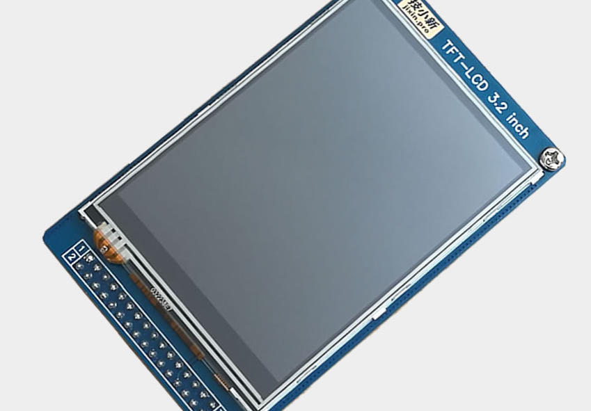

This is a LCD screen module. The LCD size is 3.2 inches and the resolution is 240*320. The LCD display part is driven by ILI9341. The LCD integrated resistive touch screen is driven by the onboard touch chip XPT2046.
Symbol |
Description |
GND | land |
VCC | power input |
LCD_CS | LCD chip select terminal (active low) |
LCD_RS | Command/data input terminal (0: command, 1: data) |
LCD_WR | Write data control terminal to LCD |
LCD_RD | Read data control terminal from LCD |
LCD_MOSI | Host output, slave (ILI9341) input |
LCD_MISO | Host input, slave (ILI9341) output |
RESET | reset pin |
DB0~DB15 | Parallel data input/output terminal [D0: D15] |
BL_CTR | LCD backlight control terminal (external pull-up, lit by default) |
TP_SCK | Clock signal input terminal for XPT2046 serial communication |
TP_CS | XPT2046 chip select terminal |
TP_MOSI | Host output, slave (XPT2046) input |
TP-BUSY | XPT2046 busy signal output terminal |
TP_MISO | Host input, slave (XPT2046) output |
TP_PEN | XPT2046 touch interrupt output (active low) |
