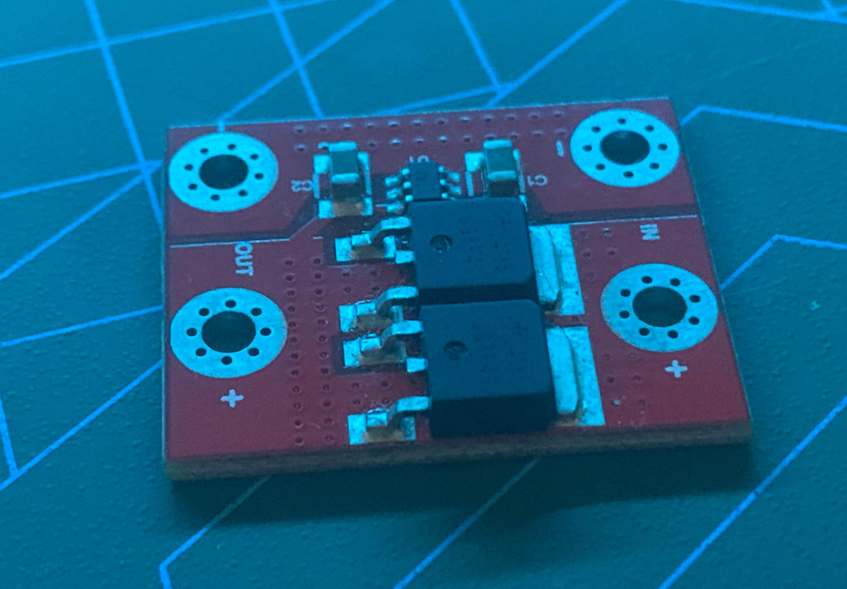

Ideal diode (tested)
Parameters: 3-28V AC/DC input;
          maximum continuous current 40A
Principle: Use PMOS parasitic diodes to prevent backflow current
Usage: Used for RM supercapacitor modules, solar cell isolation
The board tested half a year ago, only optimized wiring, real product See attachment for demonstration diagram
