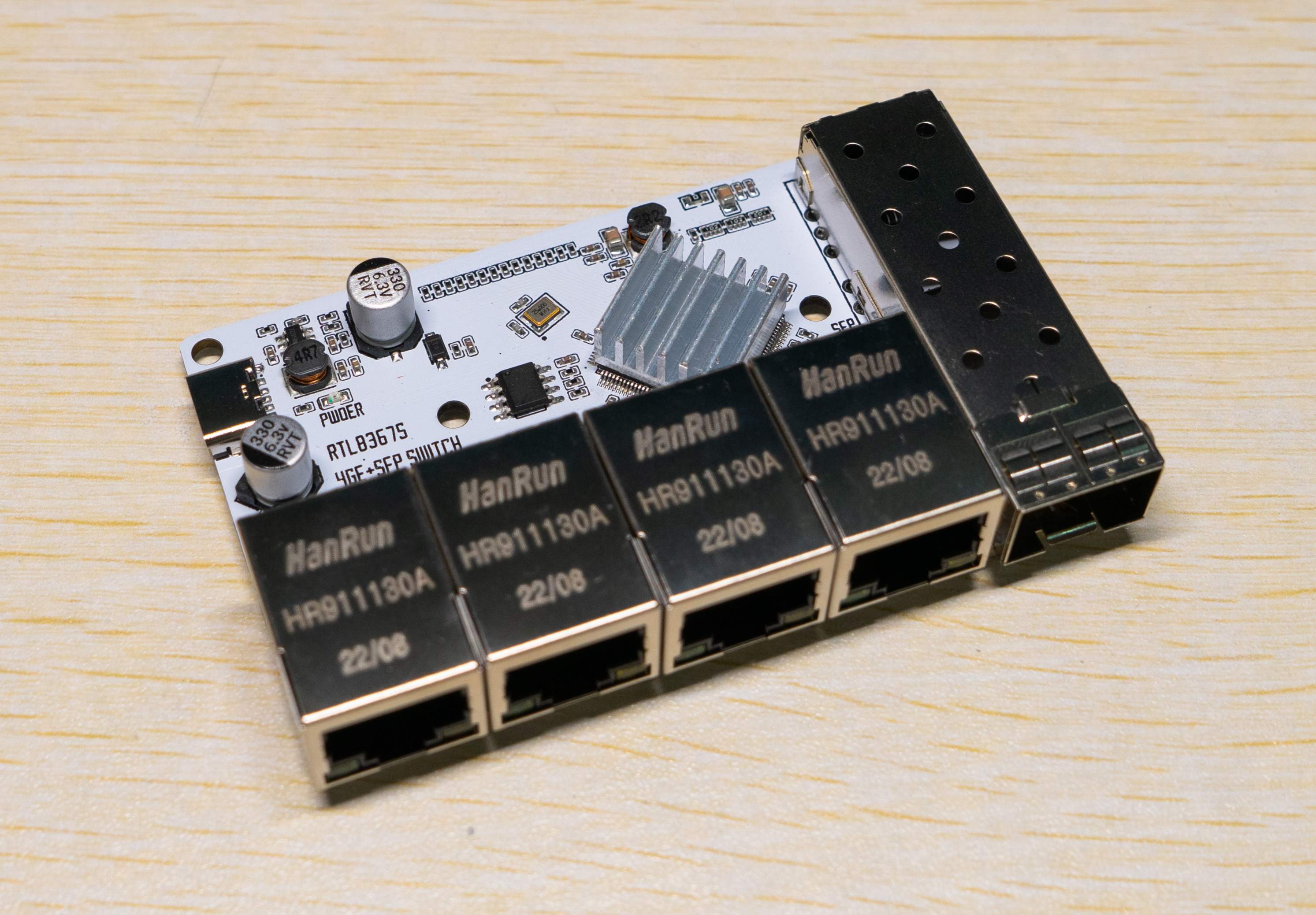

1. Project Description
This project is a 4-port + 1 optical Gigabit switch based on RTL8367S. It uses the native SGMII 1.25G optical port to lead out the SFP interface. It uses a double-layer board design + minimal peripheral components to save costs to the maximum extent.
Single-chip 5+2-port 10/100/1000M non-blocking switch architecture
Embedded 5-Port 10/100/1000Base-T PHY
Each port supports full duplex 10/100/1000M connectivity
Extra Interface Supports High Speed ​​Serial Interface SGMII (1.25GHz) Interface (the optical port uses this interface)
Supports 9216-byte jumbo packet length forwarding at wire speed
Realtek Cable Test (RTCT) function
2. Schematic Description
The DC-DC part
uses MT2492 DC-DC to convert 5V The USB power supply is stepped down to 3.3V, and the package is small SOT23. The peripheral circuit is simple, no freewheeling diode is required, and it has the advantages of small size and low cost.
The 1.1V power supply part
directly uses the on-chip integrated DC-DC output, and an external 2.2uH inductor is connected (note that the 10uf capacitor cannot be saved).

3. PCB design description
The differential routing of the network port and the optical port needs impedance matching. From the datasheet, we know that the differential impedance Typ=100ohm, ±20
uses JLC impedance calculation, when the spacing is 0.13mm, the line width is 0.142mm, and the impedance is about 100R. The differential pair can be routed as follows.
Other wiring precautions:
1. Since the network port has a built-in transformer and an isolated high-voltage capacitor, the shell ground needs to be separately coppered and isolated from the main GND.
2. Place components on the top layer, route signal lines and power lines, and the bottom layer is the ground plane. Try to ensure the integrity of the ground plane, and add a return path if necessary.
3. The SFP seat and the shell position have been matched, do not move

Final product:
Notes
1. At present, the network port 911130A sold by TB has two sizes (genuine and copycat). Generally, the original hanrun network port should be able to be inserted normally, and the side buckle of the shell of some network ports on TB has a bulge, resulting in insufficient spacing between the network ports and unable to be inserted. Don't use force to create miracles, otherwise the PCB is prone to deformation. Be sure to distinguish clearly when purchasing a network port.
2. When making PCB proofs, it is necessary to note that half holes are not made, otherwise there is a chance that half-hole fees will be added after the review, which is very expensive.
3. Be sure to add a heat sink and pay attention to heat dissipation when using it. The working temperature is high, and it is easy to lose packets or other inexplicable bugs at high temperatures.
4. Do not use low-temperature solder for solder paste or solder. The working temperature is high and there is a risk of desoldering.
5. The two electrolytic capacitors must have a capacity greater than or equal to 200uf.
6. The crystal matching capacitor needs to be determined according to the crystal data manual. If you don’t know the specific value, solder it according to the schematic diagram.
