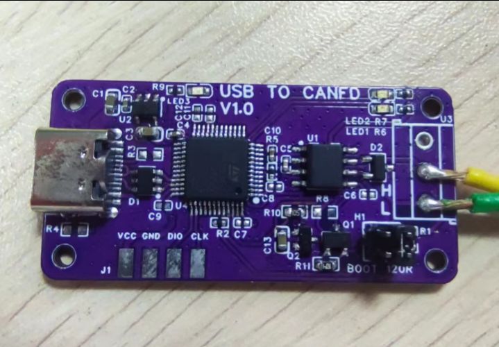

An open source USB to CAN converter tool - CANable whose main control is STM32G431C8T6, has derived a lot of open source firmware. Firmware can be updated directly via USB.
Project open source link: https://github.com/makerbase-mks/CANable-MKS
Features:
1. Online firmware upgrade via USB, online upgrade address: Updater - CANable
     Firmware can also be upgraded via USB DfuSe
2. Reserved SWD interface , can be developed independently.
Firmware download method:
The attachment provides the firmware bin file
1. Online USB upgrade
step 1: Enter the upgrade website Updater - CANable
step 2: Select the version and firmware, short-circuit the BOOT cap, click firmware upgrade
2. JLINK upgrade
3. Upgrade via USB
DfuSe Machine:
Connection settings
Receive messages:
The simplest physical picture: 2 clips are welded to facilitate wiring
