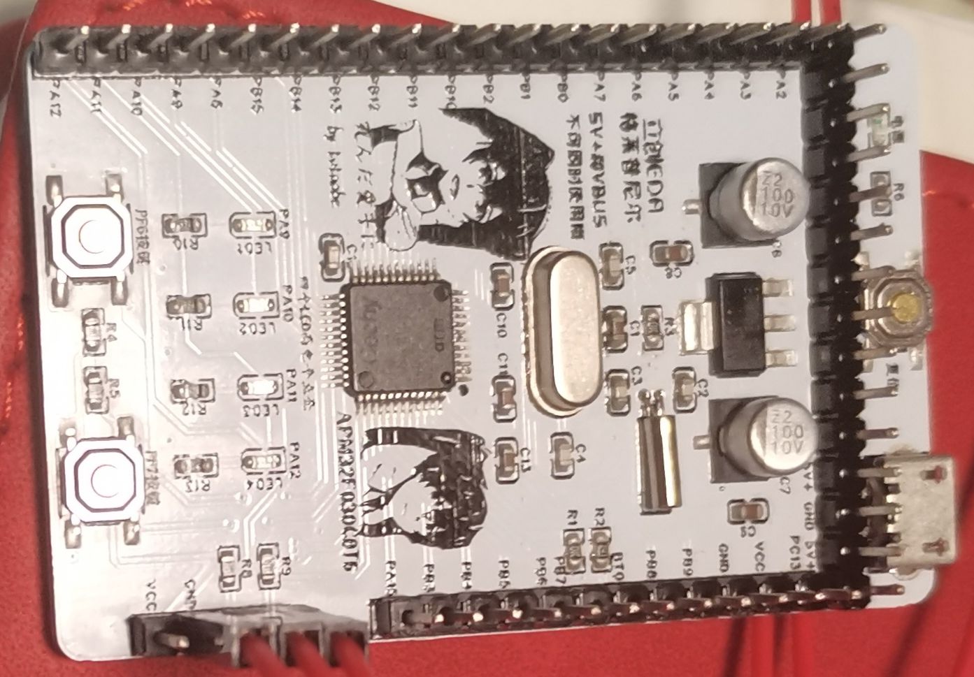

The smallest system board, the wiring is much better than before. It is the first time to use apm32 microcontroller. Someone in the forum said that the stm32 project can be burned directly. I tested it and it can be burned, but the running result is wrong. You must use the official sdk file to create a new one. The project is created in the same way as stm32. The attachment below provides a running water lamp project template that can be used directly. It is still a bit different from stm32. I drew this board because a certain fish currently has products that cost one yuan each, so I simply bought dozens of them. , there seems to be a program in it when it is powered on for the first time, but it does not affect it. Including other things, one board costs about 3 yuan. Compared with the rising price of stm32, which is easily 3 or 4 yuan, I will use this board for simple projects in the future. It can be regarded as supporting domestic production, and the illustrations are personal preferences^_^
