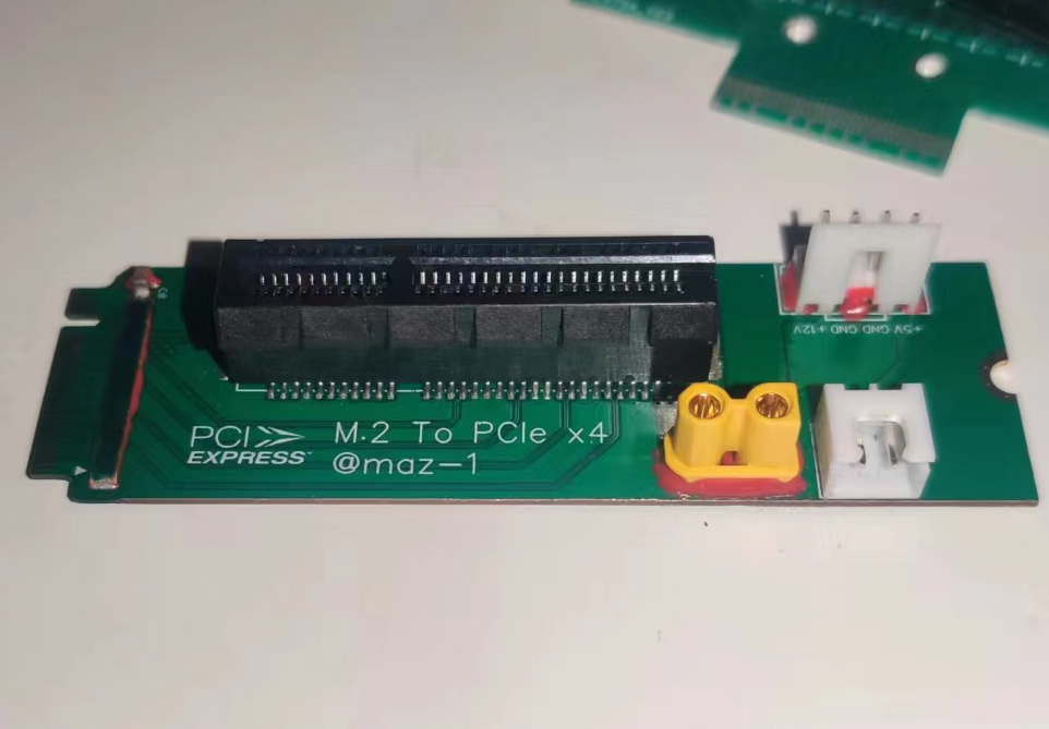

m.2(ngff) to PCIe x4
0.8mm four-layer board, impedance structure 3313.
It can be powered by small 4pin or xt30. The xh2.54 interface can be connected to a 5v fan (power is taken from the smallest 4pin).
There is no place to connect the 3v3 power supply on both sides of the m2 interface, so two soldering pads are opened.
