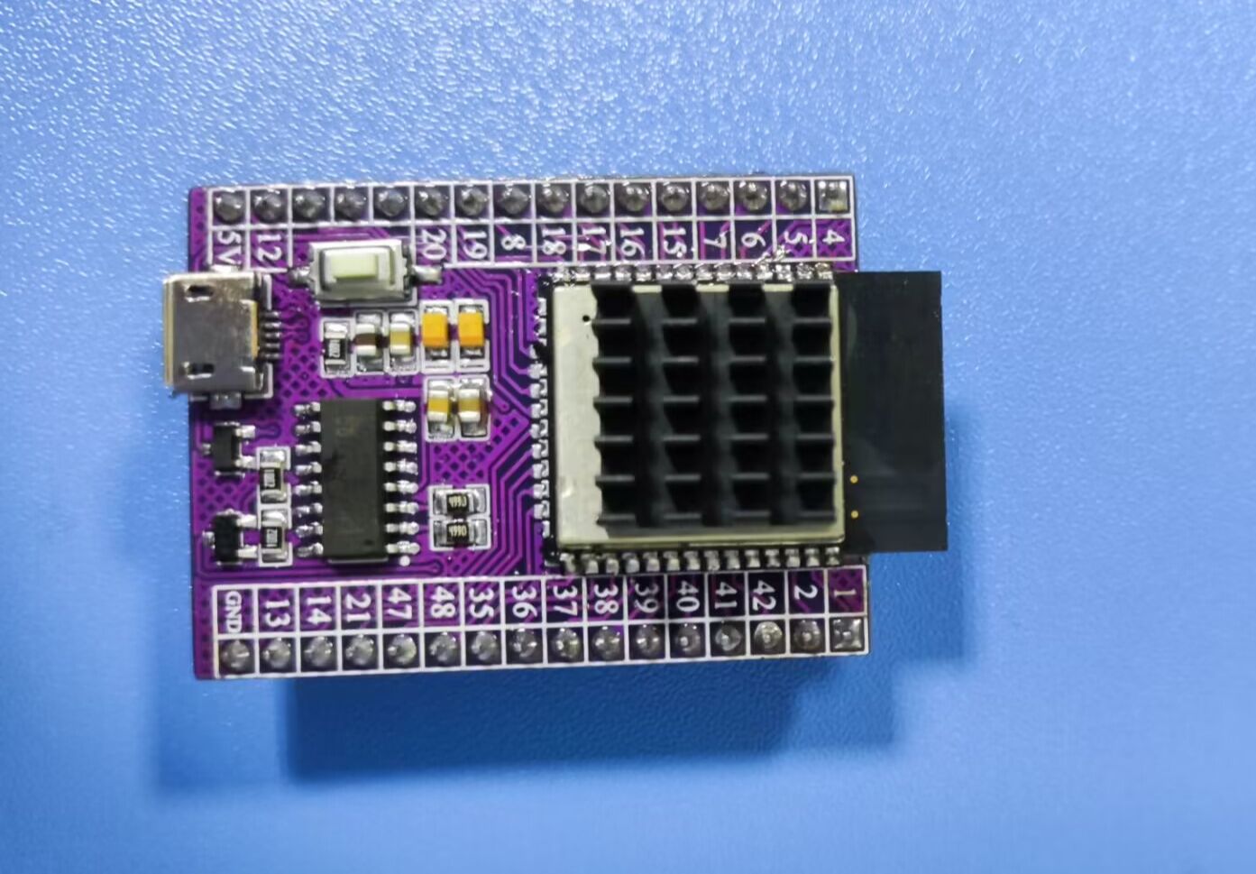

features of the physical picture of Ver1.1 version:
1 .Can realize the automatic download of the program
2.Can realize the serial port printout and carry out serial port debugging (making up for the shortcomings of the Ver1.0 version)
3.The resistors and capacitors are all packaged in 0805, which is easy to weld (0603 welding hurts the eyes^_^)
4 .Only a few components are needed to realize the design of the ESP32S3 development board, which is compact and compact~
5. The ESP32S3 module uses ESP32-S3-WROOM-1 (D2N8R8), which is compatible with other models of ESP32S3 modules. The overall price is 26 yuan. Recommended
proofing and production version Ver1.1

V1.1 version update time: 2022/11/13
Review Ver1.0 features:
No need for CH340C After testing, it was found that there is no way to perform
serial port printing. After connecting to CH340, serial port printing can be performed normally. Therefore, the Ver1.1 version was updated.
When WIFI is always on, the temperature is relatively high, so the chip is added A heat sink was installed
to replace the Type-C interface and adopt a Micro USB interface, making welding more convenient!

3. Pitfall record:
       After the board is soldered, follow the data manual operation, the COM port cannot come out, and the program cannot be burned normally. At first, I suspected that it was the board I was planning to redesign the circuit board, but after careful investigation, no problem was found, so I used the previously designed ESP series universal downloader to download a program and try it out. Unexpectedly, the program was burned in! ! ! It’s really amazing! ! !
Then, unplug the writer and power on again, and everything is normal! The port can be detected, and automatic downloading of programs can also be achieved without using an automatic download circuit.
Summary: To burn a program for the first time, you need to press and hold BOOT and then press EN (it is written in the data sheet, but it was unsuccessful). After that, whether it is automatically downloading the program or using the serial port for communication and printing, it can be used normally.

5. Physical picture:
6. Note:
When performing PCB wiring, the pins of the ESP32S3 chip have been Delete and modify (some pins cannot be used normally. After soldering, it will be more troublesome to disassemble later).
Remove the resistor on TX and add it to other circuit diagrams when it is used later (after testing, this resistor does not work. It’s okay to add them, it won’t affect normal use)
The ESD chips are too small and difficult to solder, so I removed a few, so there are inconsistencies between the components on the PCB and the schematic diagram!
