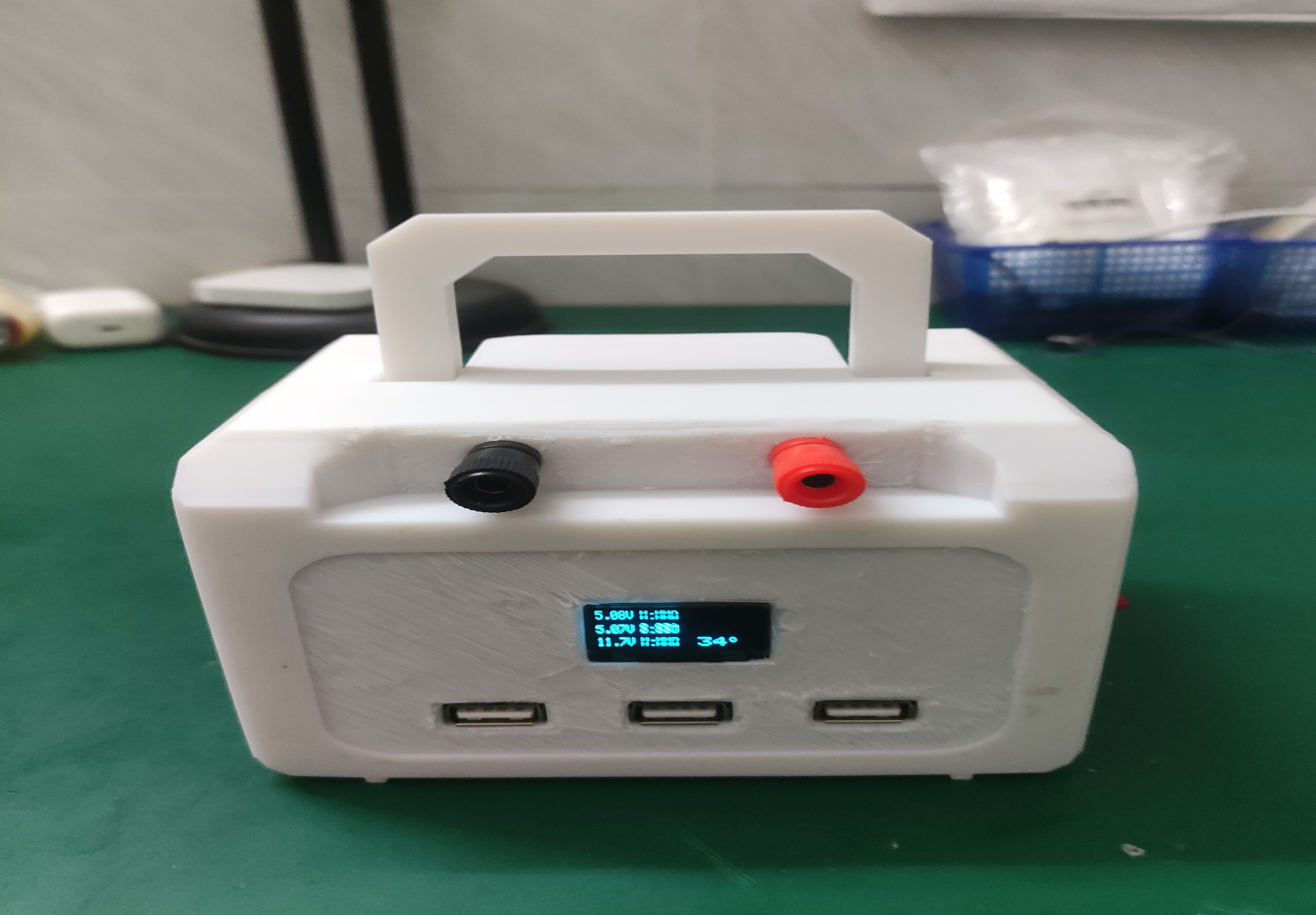

-This project uses **IP6536** to provide two **5V 1.5A** USB charging ports, **IP6505** provides a maximum **24W** USB fast charging port that supports **QC3.0 / DCP / QC2.0 / MTK PE1.1 / PE2.0 / FCP / SCP / AFC / SFCP** fast charging protocols, and the battery is charged by **type-C** input through **IP2326** output with a maximum **15W fast charging** to charge the battery, N32G430K8Q7 is used for screen drive, three-way USB, fast charging protocol detection, 12V output, battery power voltage and current detection, terminal output 12V up to 10A, power supply mode: battery power supply/DC port power supply (up to 15V) ***** The battery must be disconnected when powered by DC.
### * 2. Hardware part:
Lao Ma's protection board, electric car battery bought for 40¥**3 series and 6 parallel**
![微信图片_202209072330073.jpg]
![微信图片_20220907233007.jpg]
![微信图片_202209072330071.jpg] ![微信图片_202209072330077.jpg] This is VER:1.0 and needs flying wires, VER:1.2 has been modified
![微信图片_202209072330078.jpg] The screen is fixed with EVA sponge (I didn't take it into consideration when drawing the shell)
