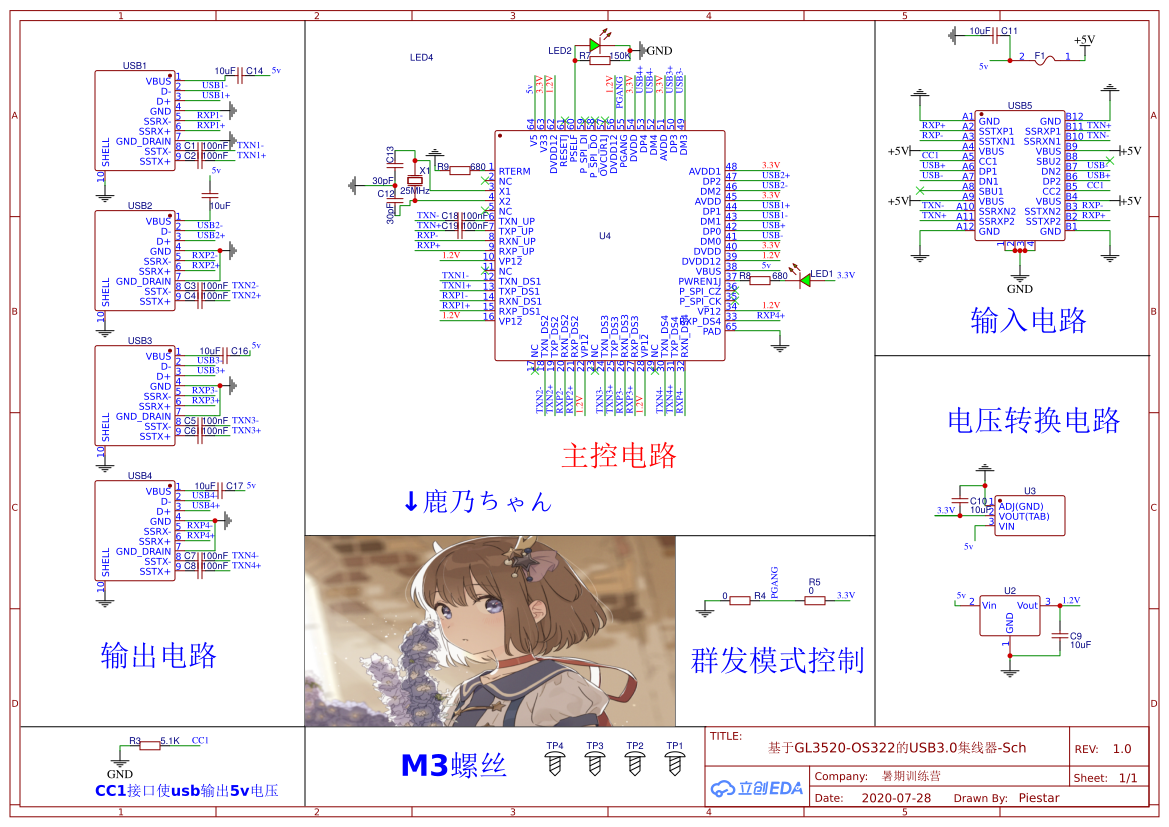

[Training Camp_Basic Class] Hub based on GL3520-OS322
USB3.0 high-speed hub based on GL3250-22 chip, GL3520-22 is a 4-port, low-power and configurable hub. And backwards compatible with all USB 2.0 and USB 1.1 hosts. The chip has a built-in 5v-3.3v voltage regulator. Up to eight devices can be connected (matryoshka warning). Because I'm not very skilled, my drawing of PCB is rather poor. I’ll revamp it when I have time (I’ll definitely do it next time). I haven't received the board yet, so I don't know if it can be used.
