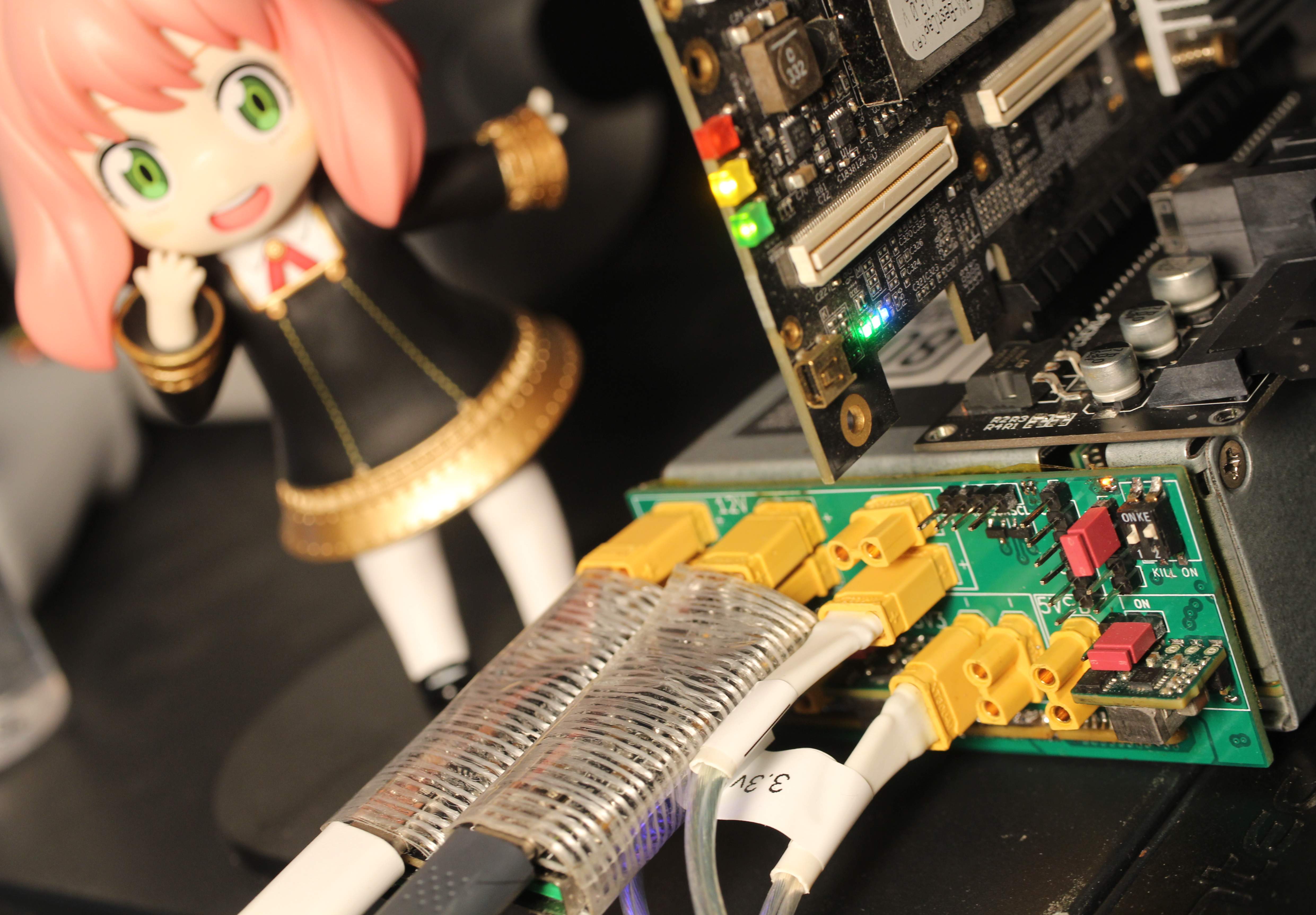

Dell server power outlet strip that does not require connectors
No need to buy expensive connectors for power outboards, use soldering for inter-board links.
The power module is ZTE ZXDN10. The power interface is XT90.
Lead out 6 12v, 2 5v, 2 3.3v, 1 5vsb.
i2c has level conversion, to 3.3v, and the control terminal wires are all drawn out.
