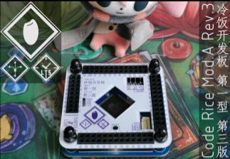

# Project Description
![Cover.png]
This work is the third development board based on ATmega 2560 designed by me. Compared with previous projects, this work has a friendly pin sorting and single-sided mounting layout while maintaining a small size.

### About the panel
The first test version of the top panel was successful! Since the interface of the development board is almost close to the load-bearing limit of this shape, the connection of some parts of the panel is relatively weak and may break under impact, but it does not affect the use. I left a relatively large margin in the female header slot. If I am confident in my assembly precision, I can slightly reduce it to increase the mechanical strength. The bottom panel is still under design adjustment, but since it does not involve slotting and only pattern design, you can play freely!
See the attachment for specific design drawings!
