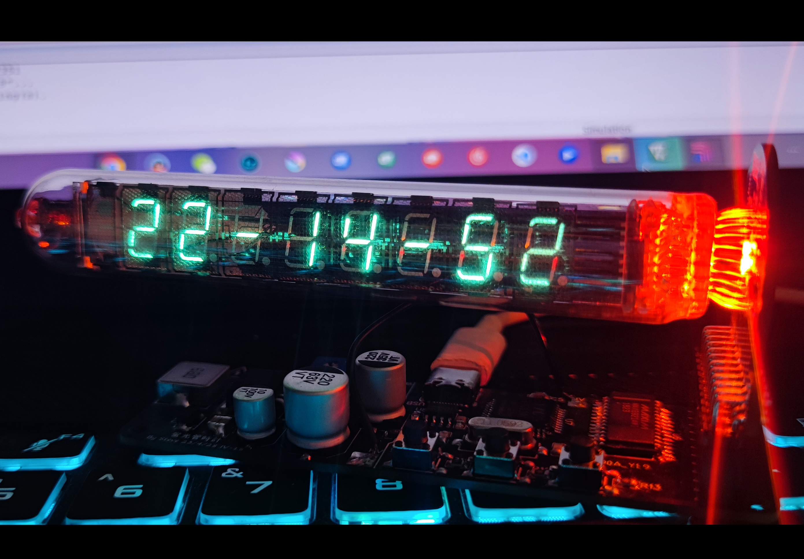

The XL6019E1 is overqualified for use. Just use the example circuit in the data sheet. The voltage adjustment can be done by modifying the feedback resistor or the upper adjustable resistor (Vfb=1.25V). In fact, it should be fine to use SX1306. I don’t have an oscilloscope to measure ripple, so I just use it like this, and there’s no big problem. Note that the anode voltage is suitable for brightness within 49-53V.
Control part:
Basic keil C51 programming, mcu is 89c52, be sure to check 6T when burning the program! ! ! There was a mistake here during the design:
the bit selection was connected to OUT19~13, but there were three empty bits in the middle, so switch-case was used in the code to perform bit selection simply and crudely.
Another point is that the filament voltage was set at 3.3V during the initial design, but the brightness was too low, so the 1117 on the back of the PCB was directly connected to a lump of tin, and a 5V filament power supply was suitable! Current limiting resistor R3=50R.

The following is a display:
