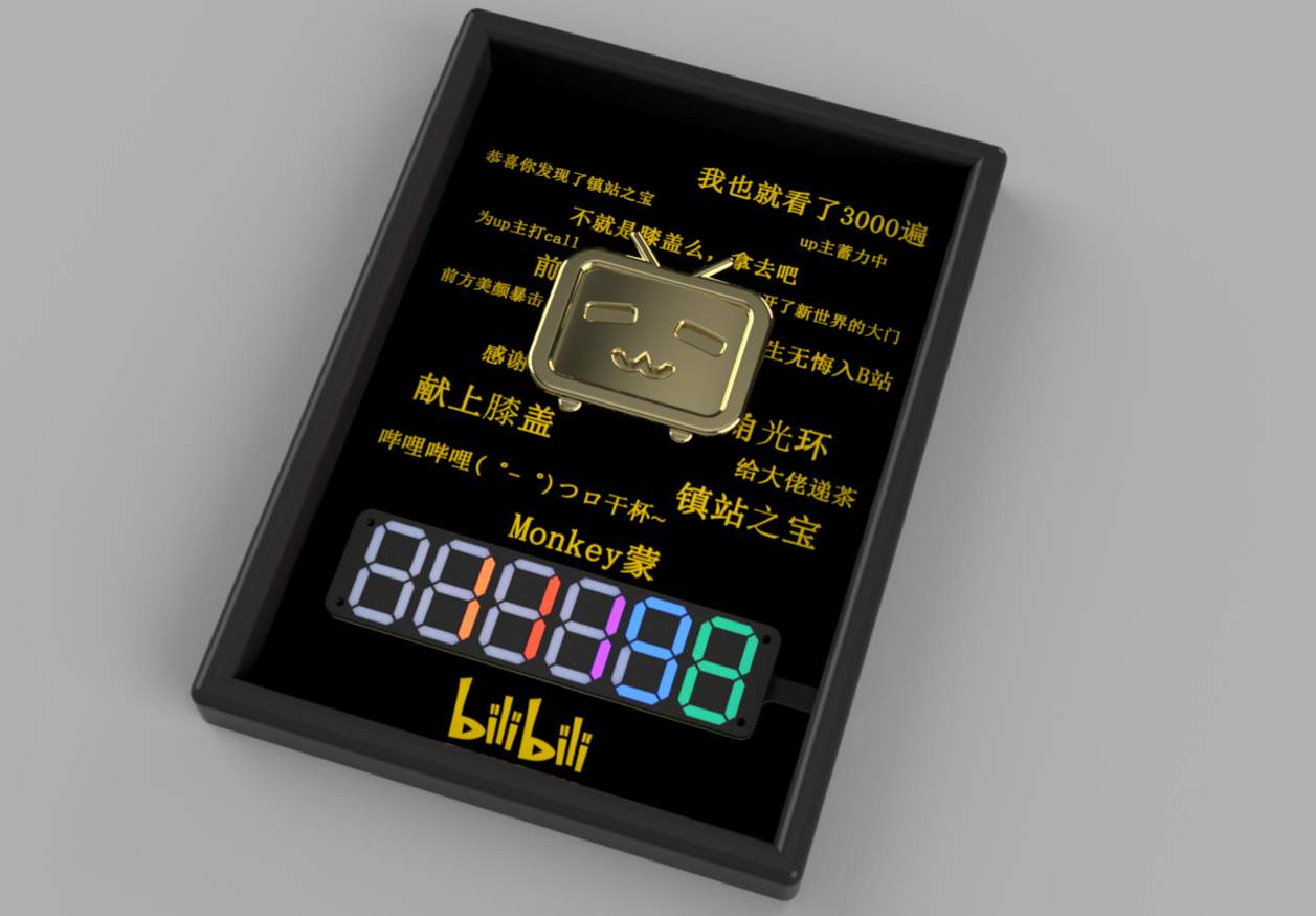

2. For the structure part
        , in order to make the overall design more beautiful, in addition to the circuit design, it is also necessary to design a shell for the device. Since there are no customized products that meet the requirements of the photo frame on the market, I used 3D modeling software to design the shell of the entire device. On the front of the device, four cylindrical slots are reserved to fix the circuit board.
     In addition to the outer frame, since the LED lights on the circuit board are too scattered when used directly, a lampshade is also designed here to cover the PCB board to gather the light beam.
        The 3D rendering of the PCB and the lampshade is shown in the figure below.
        Finally, there is the golden small TV. After observing the medals of Station B and adding my own imagination, I designed this golden small TV in 3D modeling software, and finally chose CNC brass and mirror polishing technology to process it. The final effect is still lever.
        The real object after processing is also handsome to me. The left one is aluminum CNC sand gold bright anodized, and the right one is brass CNC mirror polished.
        In the end, the combination becomes a cool million fans medal. 2.     The final designed object
of the structure is shown in the figure below:     All the information of this project will be placed in the attachment, and interested friends are welcome to copy it.
