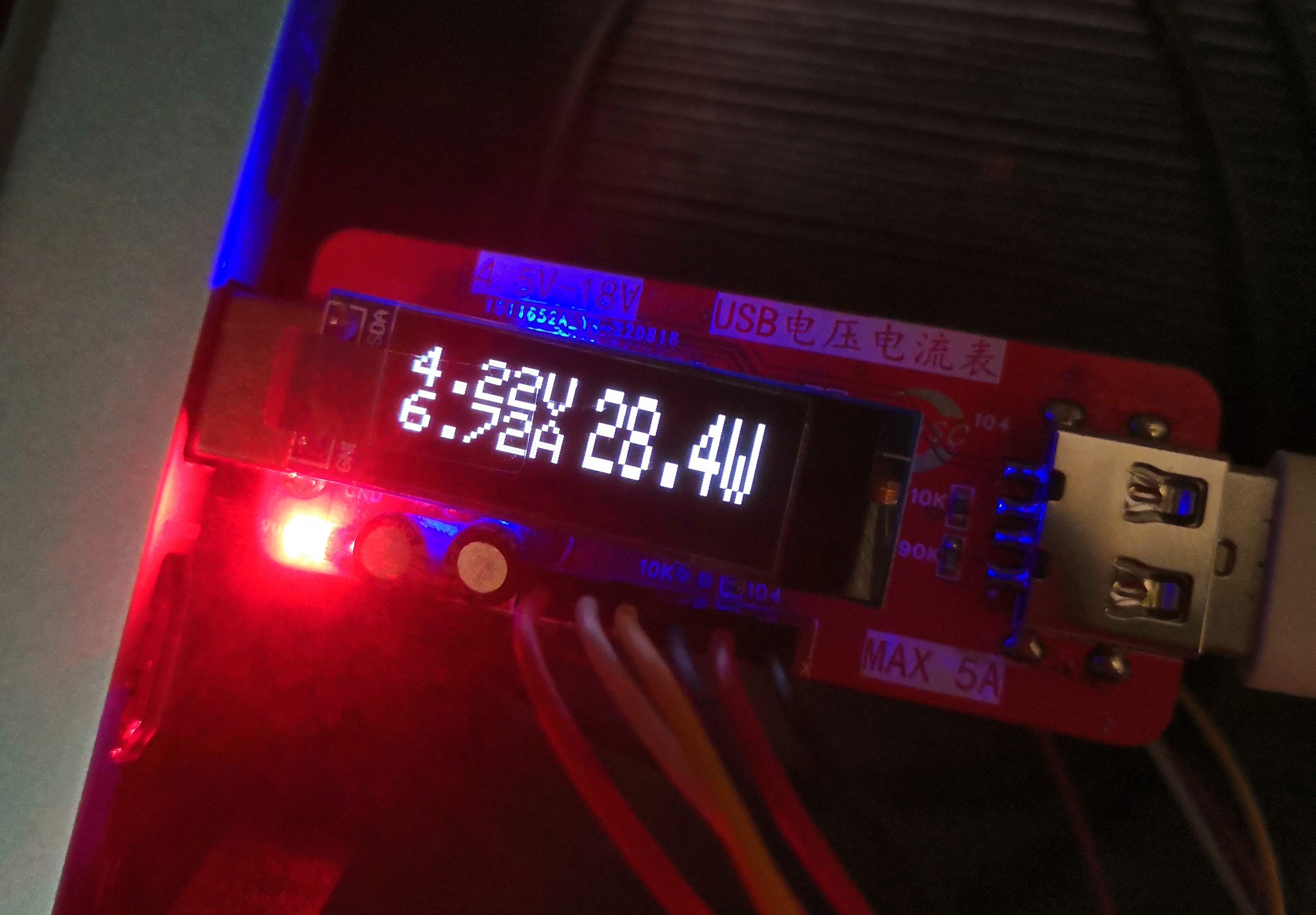

* 1. Introduction to project functions:
Measure voltage and current through USB and calculate power
* 2. Project attributes:
Jialichuang Summer Training Camp 2022
* 3. Open source agreement:
GPL3.0
* 4. Hardware part
1. The training camp solution for collecting voltage and current, the voltage regulator 3V3 uses MP2225 to support a maximum current of 5A, and the input voltage range is 4.5V-18V, which can increase its application range;
2. The main control uses the national technology N32G40C8L7, which is 5 yuan cheaper;
3. Use INA199 for current sampling;
* 5. The problem encountered
should be a hardware problem that causes the current to be close to 7A when unloaded, and the display is abnormal.
