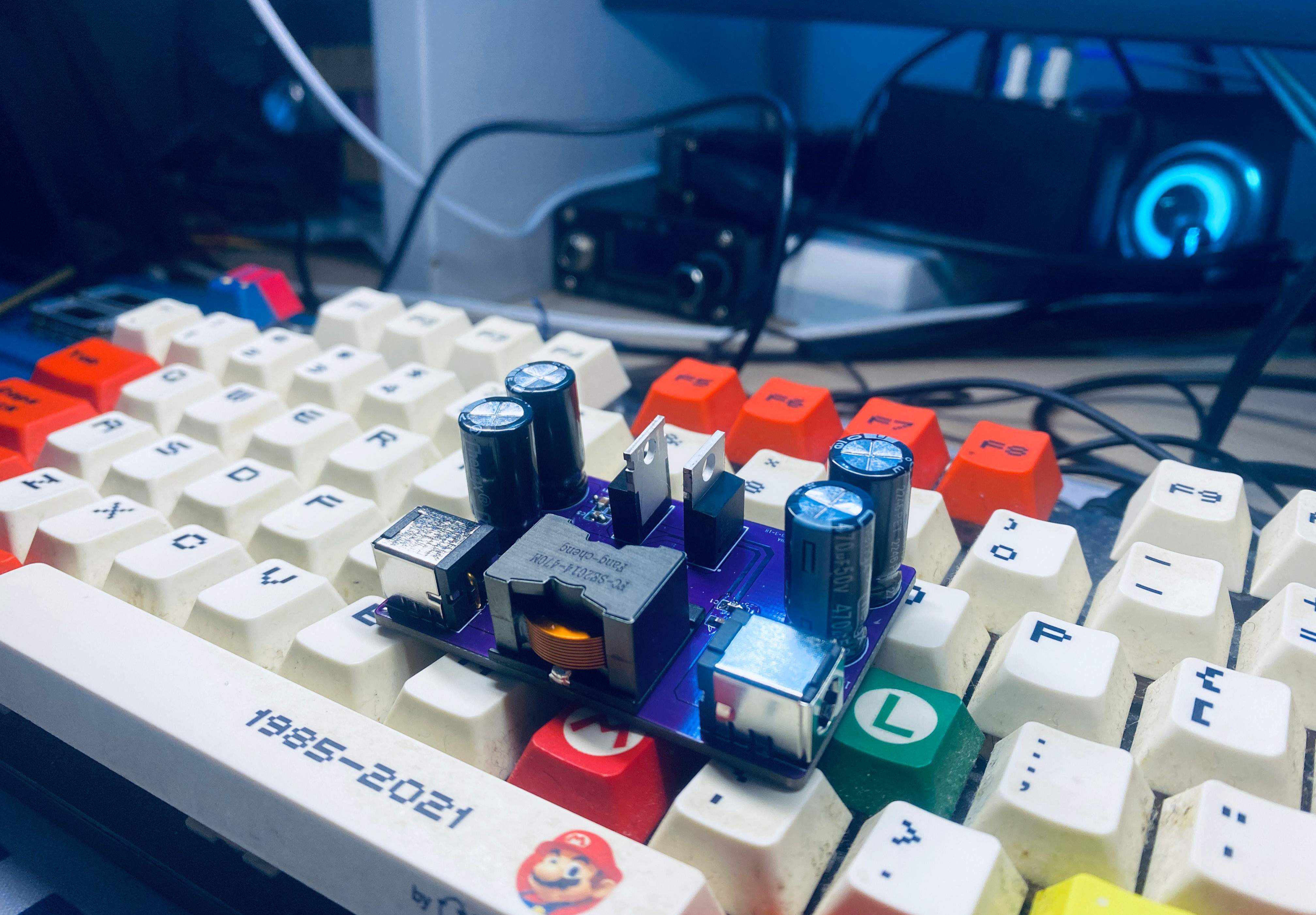

Based on XL4016 high current 12V/9A-DCDC
1. Introduction
Based on XL4016 high current 12V/9A step-down board, both input and output use DC power socket inner diameter: 2.5mm outer diameter: 6.5mm, fixed 180KHz switching frequency, built-in output over-current protection, function. Low ripple, excellent linearity and load regulation characteristics.

You need to pay attention to the problem of large current heat dissipation. It is recommended to use heat dissipation chip and other cooling solutions.
There is no short circuit protection. Pay attention to the positive and negative poles during the test.
5.
There is no suitable heat sink in the actual picture, and it is not loaded in the actual shot.
