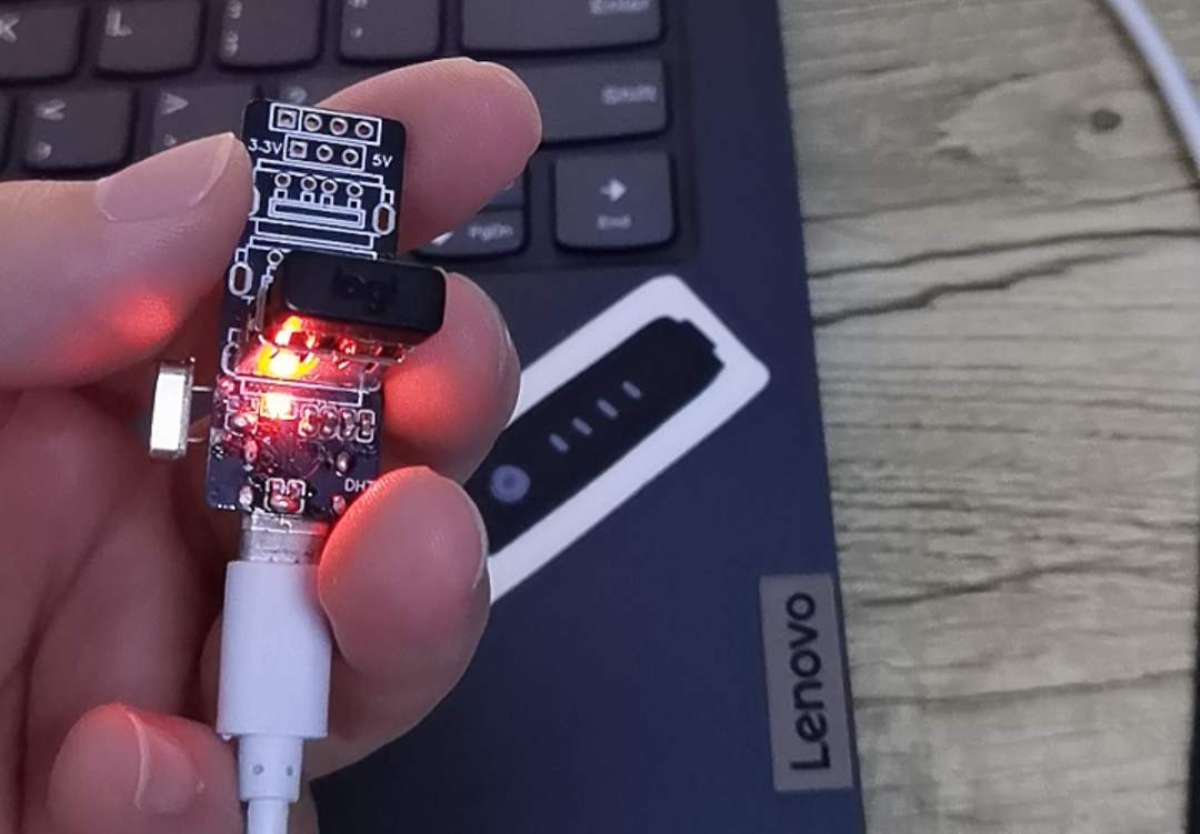

It has been verified and can be used. Please note that the two capacitors under typeC must be soldered, otherwise they will not be recognized. There is also a resistor where the fuse is located. Please pay attention.
