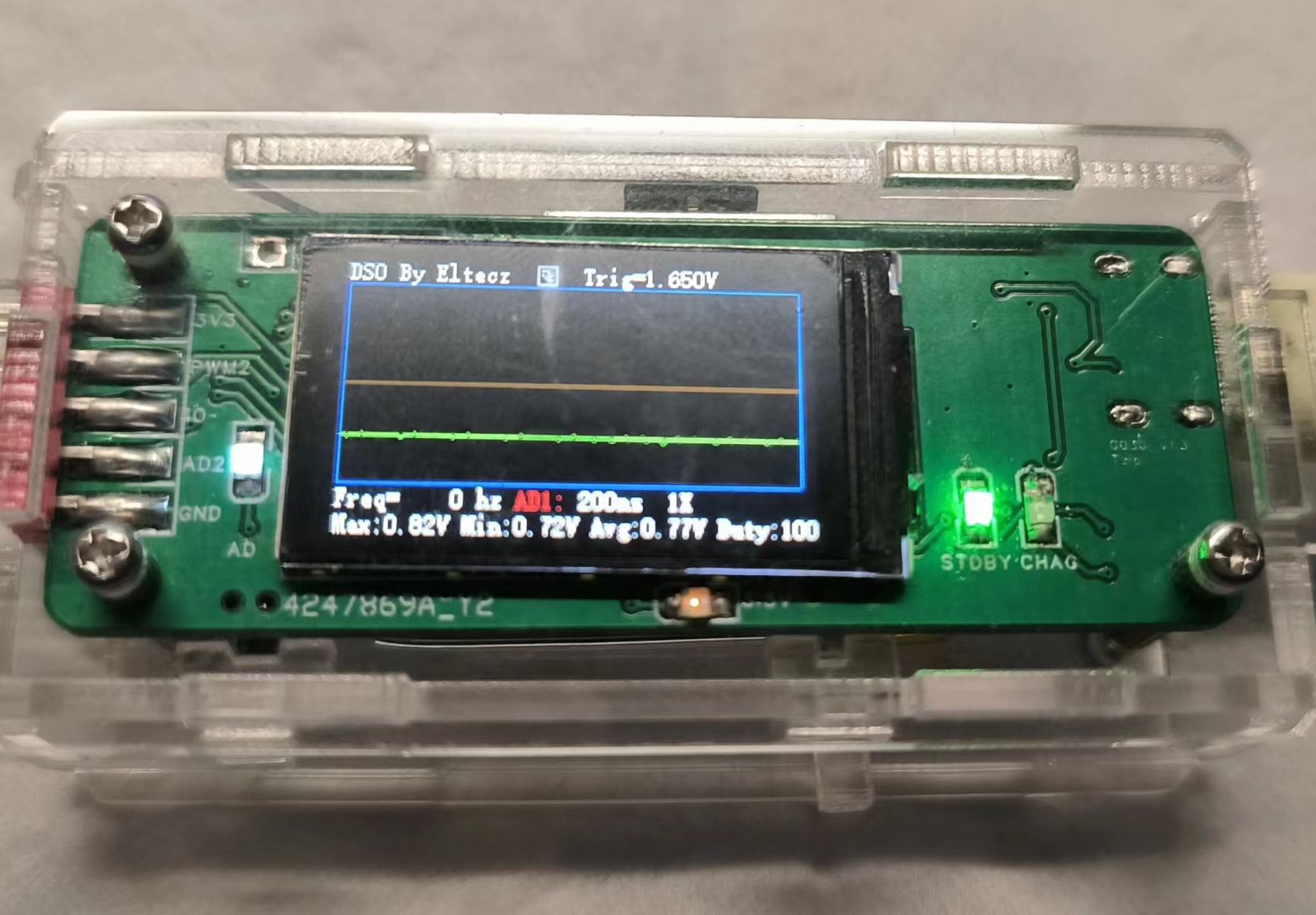

STM32G0 oscilloscope (shell version)
Tip: It cannot run after compilation and downloading using Keil. Then delete the original file, re-decompress the source code and download it directly into the board.
Compile and error. Change AC5 (Target->Code Generation-ARM Compiler select V5.06).
Please do not use force when installing acrylic. Once the Miracle
battery socket is plugged in, it is difficult to unplug it, so when connecting the battery, please double-check whether the positive and negative poles of the battery are correct.
The display will light up during charging (because the power supply is directly connected), but it can be fully charged normally. Although, I still It will not be made to shut down when charging (cannot change the code and low technical skills).
There are cutting files, installation pictures, material tables and source codes in the project attachments.
Original author: Eltecz Open source link: https://oshwhub.com/eltecz/stm32g0osc_s (If there is any disadvantage, please point it out and I will be very grateful)
