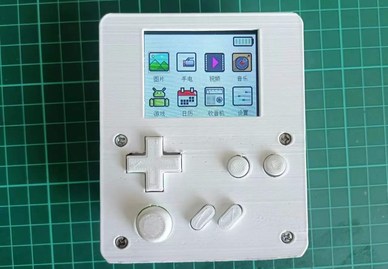

The fourth version of the game console (the 3D print has been updated four times)
! [Main image.jpg] 2. Software design
(1) Menu design
! [GUI menu.jpg] Game console menu, select each application through the red box, ready Developed using LVGL, but was not successfully transplanted. The menu uses a combination of pictures and Chinese characters. Xiangjian program.

3. Summary:
Use the Liangshan School development board to design a game console and understand the function of each pin and its application in the circuit. I did not pay attention when designing the cross button. The pins are used on the pins of the SD card. There are upper The resistor is unusable and has been corrected in the circuit. The power supply circuit is connected to the 5V power supply of the development board, but the boot function cannot be realized. However, the power supply circuit can be connected to 3.3V, and the circuit has been corrected. For the 3D print, the screen window was too big, so I had to make three revisions before correcting it. The 3D print has been corrected. In the process of making my own game console, I learned the PWM, DAC, ADC, GPIO input and output of the development board, and the driver writing for the IPS screen. The functions of the Liangshan School development board are still very powerful. If you have time, improve the various functions of the multimedia game console, and do not let the Liangshan School eat ashes and squeeze out all the functions of the Liangshan School.
