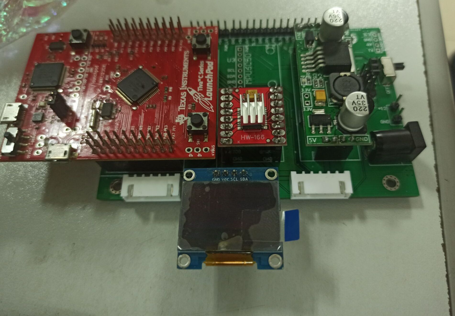

The bottom board of this car uses tiva-M4 as the main control board, which integrates a variety of power interfaces, step-down voltage stabilizing modules, motor drives, qei input and other basic functions required by the DC motor bottom board. In addition, it also expands many functions at appropriate locations. A servo output interface, Bluetooth module, OLED and other parts. It can realize basic functions such as driving the car and qei detection. In addition, it is equipped with a multi-channel PWM output interface, which can be easily connected to control the steering gear. In addition, it is equipped with an OLED display module to support the analysis of the car's rotation angle, driving speed and other information in the competition questions. show.

2** , **Circuits and Programming
The power supply consists of model aircraft battery and voltage transformer and voltage stabilizing module lm2596s. Provide 3V, 5V and 12V voltage for the car system to ensure the normal and stable operation of the circuit. This part of the circuit is relatively simple, so it will not be described in detail.
