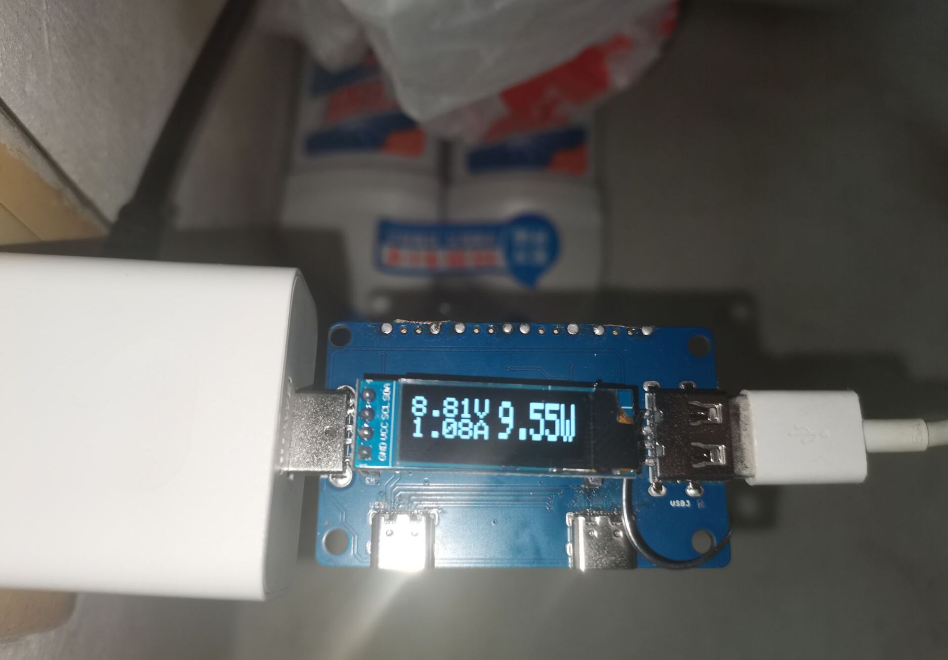

* 1. Project function introduction
4.75--25V; 0-5A can be measured
* 2. Project attributes
LiChuang training camp
* 3. Open source agreement,
please fill it in during the competition stage↓
*4. Hardware part
PCB uses Jia LiChuang EDA to design
the current sampling using TI's INA199 current sensor amplifier, the sampling method is low-side sampling
The voltage sampling part consists of a series voltage divider circuit composed of two resistors
. 4 buttons are reserved for later expansion. The three-channel sampling voltage can sample D+D- and input voltage respectively
