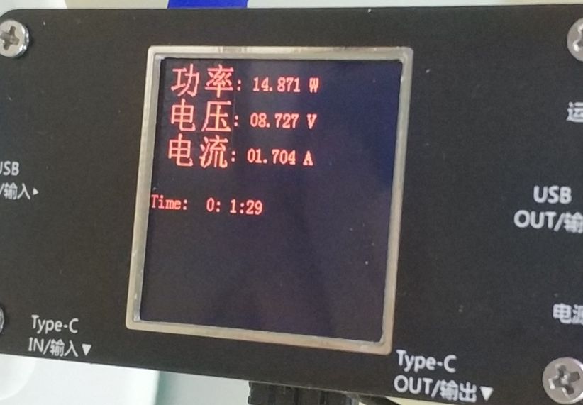

* 1. Project Function Introduction
USB power meter based on N32G430C8L7_MCU and INA226. Range: Recommended range 5~20V, 0~5A. Limit parameters 5~36V, 0~8A

In order to adapt to the private fast charging protocol of mobile phone manufacturers such as Xiaomi, the hardware part selects a 5PIN USB-A interface, which has an extra cc connection, which is connected to the cc1 of typec to implement the private PD fast charging protocol.
The voltage and current sampling part
uses INA226 .
The power supply part
uses MP2451DT. The recommended range is 5~20V, 0~5A. The output is 3.3v to provide 3.3 power supply to the chip and on-board devices;
the display screen
uses a 1.3-inch IPS LCD screen
