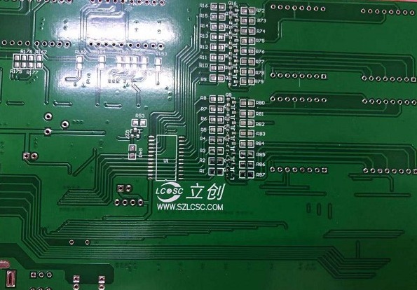

PCB processing progress:
![image.png] Jialichuang is still good at production and can also produce the next side STM patch:
![image.png]
