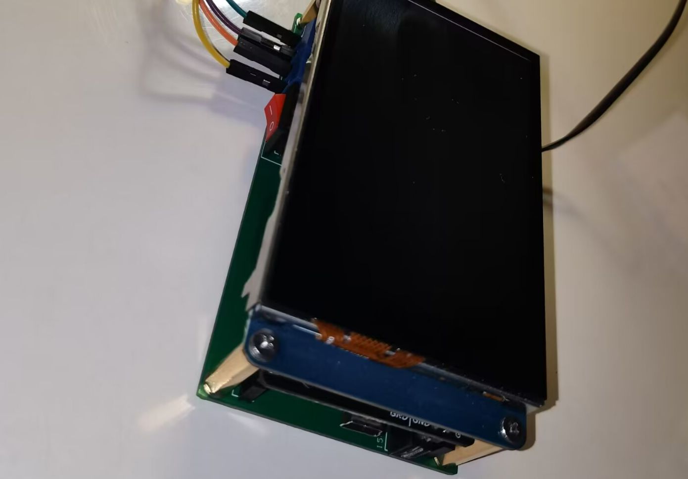

Physical display descriptionThe
serial port screen is installed on the PCB board, and the modules communicate through the usart protocolMobile
