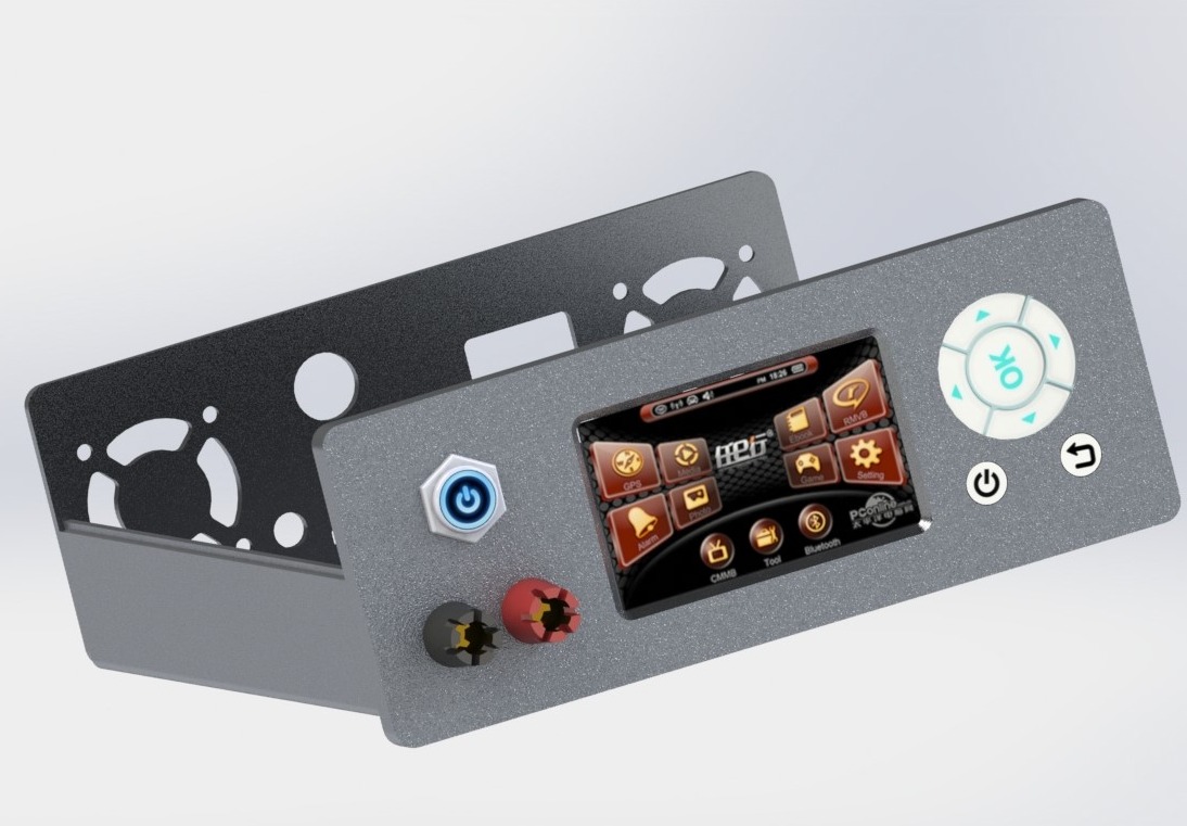

4. Multiple operation modes, integrating 5 human-computer interaction modes
(1). Button operation, operating the power supply through 5 navigation buttons + 2 function buttons.
(2). Touch operation, using a 3.5-inch large-size capacitive touch screen and display panel, with high operating sensitivity.
(3). Browser operation (intranet), after connecting the device through WiFi or network cable, open the computer or mobile browser to access the IP of the CNC power supply to open the operation interface.
(4). Remote control through the mobile app while connected to the Internet (external network).
(5). Remote control through computer under network (external network) status.

#### **Involves many aspects, including hardware development (3 PCBs schematic diagram and board drawing), structural development (the panel is 3D printed for proofing) Linux kernel development, driver development, QT application development, microcontroller development, the server backend is developed using NodeJS, and the front end involves Vue development. Alas, a rogue is alone during the day. I was at work and was too busy to work at night, so the project was delayed. The main interface (desktop) is developed using AWTK (Zhou Ligong GUI), the file system is compiled using buildroot, and the QT5 library is configured. **
#### **This project will be fully open source and will be continuously updated in the community for everyone to DIY. Interested partners are also welcome to participate in joint development. Work together to create an open source community environment. **![IMG_20200827_204759.jpg]
