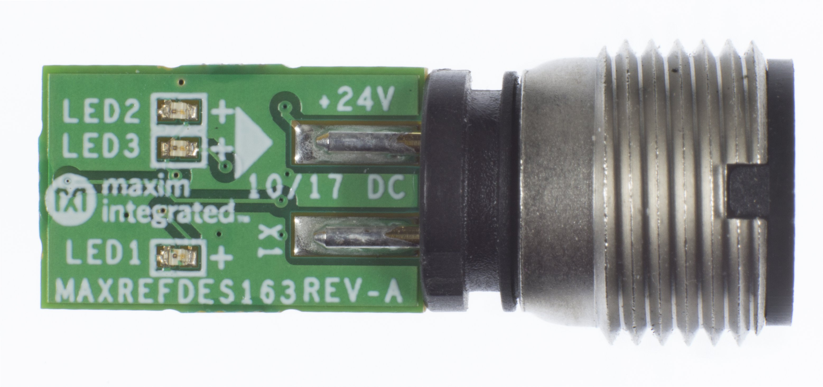

The MAXREFDES163# is one of the world’s smallest industrial magnetic sensor solutions that uses a RedRock™ RR120 TMR integrated digital magnetic sensor and the MAX14839, an industrial sensor output.
The reference design PCB dimension is just 15mm long x 10mm wide, with the width determined by the size of the M12 connector.
Design files can be found on the Design Resources tab. The board is also available for purchase.
  • Tiny Form-Factor, M12 Connector
  • Integrated Protection Provides Robust Sensor Solution
    • Reverse-Polarity Protection on DO, VCC, and GND
    • VCC Hot-Plug Protection
    • Thermal Shutdown Protection
    • ±1kV/500Ω IEC 61000-4-5 Surge Protection
    • ±8kV IEC 61000-4-2 Air Gap ESD Protection
    • ±6kV IEC 61000-4-2 Contact ESD Protection
  • Industrial Binary Sensors
  • Proximity Switches
  • Magnetic Sensors
