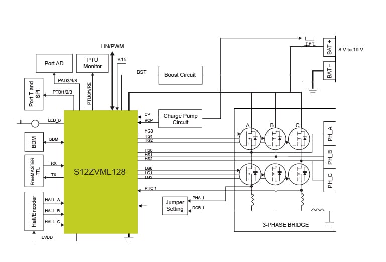

The S12ZVM-EFP is a reference design board designed for 12V three-phase permanent magnet synchronous motor (PMSM) automotive electrical fuel pumps (EFP), ready to use out of the box.
It is based on the 16-bit S12 MagniV® S12ZVM mixed-signal microcontroller and uses smooth crossover IF startup and Initial Position Detection (IPD) algorithms to ensure robust and fast startup, reaching rated speed from standstill in less than 150 ms.
