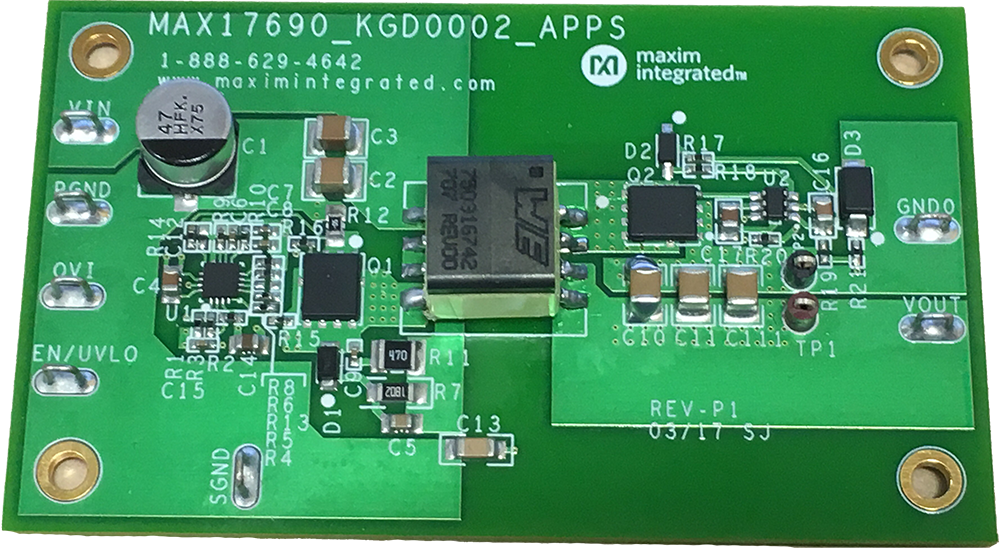

A no-opto flyback DC-DC converter using the MAX17690 is demonstrated for a 12V DC output application. The power supply delivers up to 0.5A at 12V.
Designed, Built, Tested
This document describes the hardware shown in Figure 1. It provides a detailed systematic technical guide to designing a no-opto flyback using Maxim’s MAX17690 current-mode controller. The power supply has been built and tested, details of which follow later in this document.
