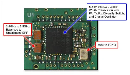

802.11b/g RF front-end module reference design using the MAX2830
Figure 1. Reference design circuit board showing the MAX2830 in an 802.11b/g RF front-end module
key design features
  • Cascade receive noise figure is 6dB
  • Low phase noise of -95dBc/Hz at 10kHz offset
  • Under 802.11g 54Mbps OFDM signal, Rx EVM < 9% when receiving sensitivity is -74.5dBm
  • Receive gain control range is 95dB (32dB RF and 63dB BB VGA)
  • Tx EVM < 5.6% when transmitting 802.11g 54Mbps OFDM signal at 15dBm output power
  • The transmit gain control range is 25dB
  • Supports full-scale 802.11b/g data transmission rate
  • Small size 11mm x 16mm
  • Low BOM cost
