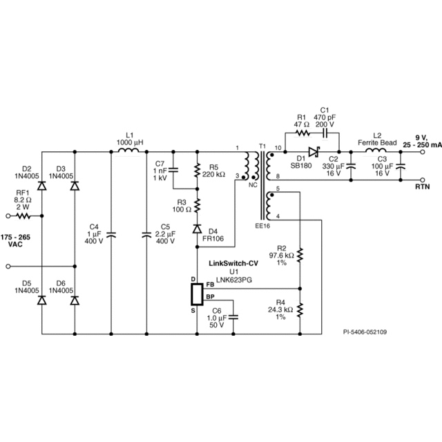

DER-214 - 2.25 W low-cost stove controller
DER-214 - 2.25 W Low Cost Cooktop Controller
This document is an engineering report describing the power supply to the range controller. It operates over a voltage range of 175 – 265 VAC and provides 2.25 W of isolated 9 V output. The LNK623PG device in the LinkSwitch-CV family of ICs is designed to provide an extremely low cost, low component count solution. This document contains power supply specifications, schematics, bill of materials, inductor documentation, printed circuit layout and performance data.
Blockdiagram
